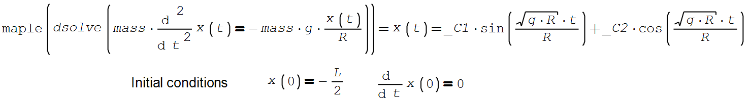

WroteSee please one ODE symbolic solution without IC
We have it done for exporting formula c/w constants & IC

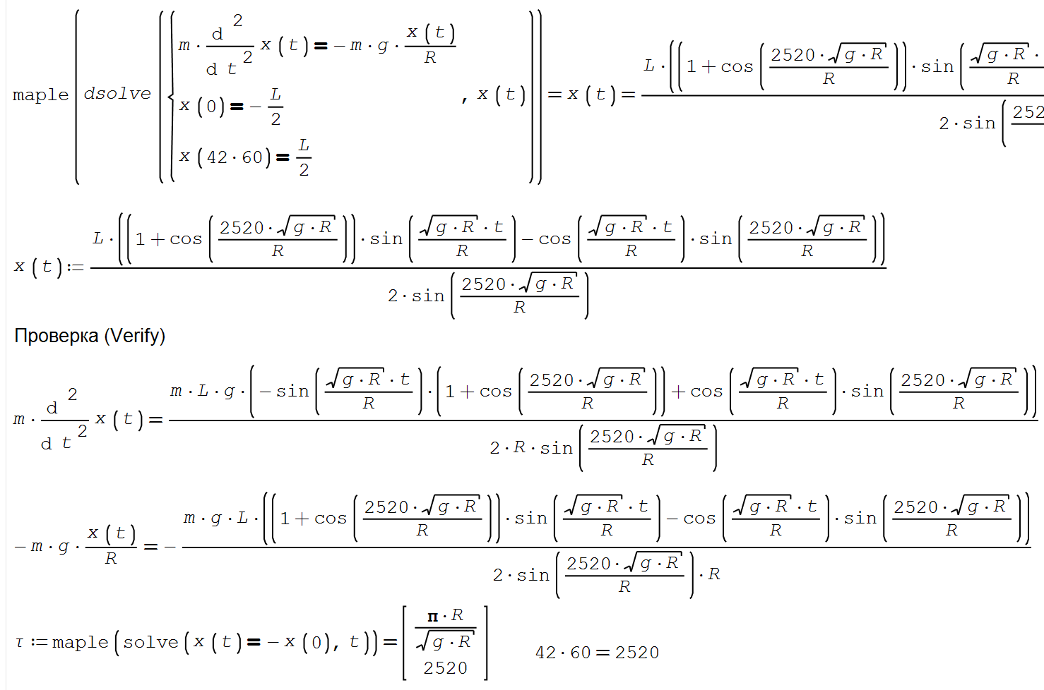

Thanks!
But no way to do so in SMath

"L & m" are missing in dsolve result ?
m is missing in dsolve.

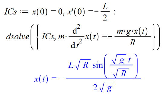

#6 Posted: 7/2/2023 4:06:01 AM
WroteWroteSee please one ODE symbolic solution without IC
Hi Valery. Use Ctrl+Shift+K for write D(x)(0), which means x'(0)
Thanks!
dsolve-ICs.sm (10.61 KiB) downloaded 1525 time(s).

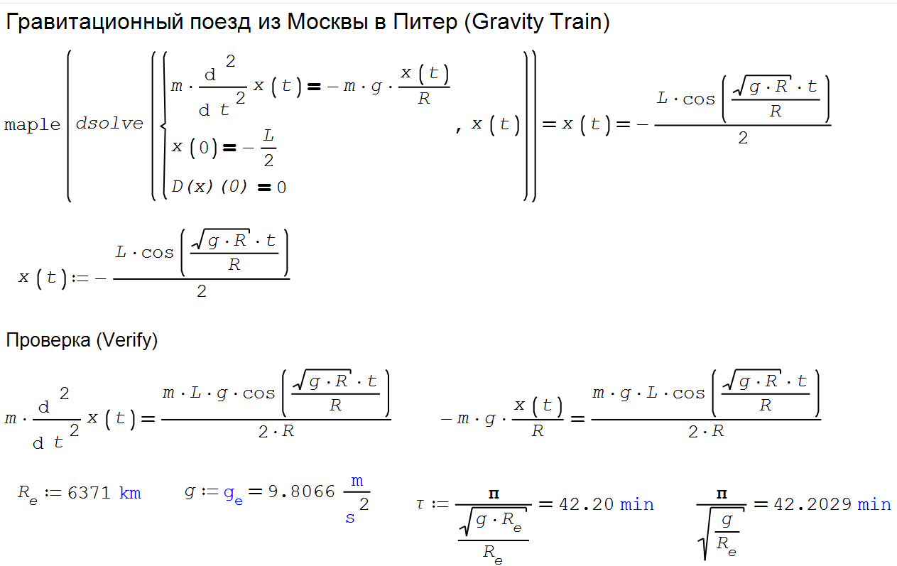

#7 Posted: 7/3/2023 3:43:12 AM
The distance between the cities added.
GravityTrain.sm (31.01 KiB) downloaded 1447 time(s).
GravityTrain.pdf (233.1 KiB) downloaded 921 time(s).
Valery Ochkov 7/3/2023 4:18:00 AM

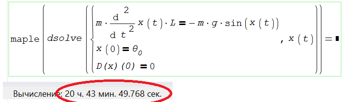

WroteA pendulum ...
The exact solution needs some handwrite work.
Edited: a hard handwrite work. Previous version was wrong.
Correct solution -> pendulum v2.sm (13.73 KiB) downloaded 1459 time(s).
Wrong solution -> pendulum.sm (13.88 KiB) downloaded 1465 time(s).
