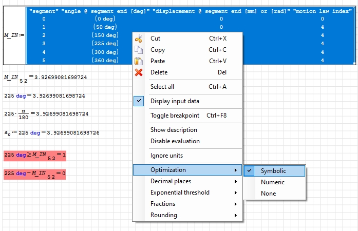

Dear all,
In a cam profile generation program, I perform some boolean operations with angular values (input in degrees).
I noticed some boolean operations fail due to a varying accuracy.
The file in attachment will clarify what I mean.
How can I make these values equal? Reduce the amount of significant numbers?
Thanks in advance for any feedback!

Wrote...
...Accuracy.sm (7.11 KiB) downloaded 1708 time(s).
Choose symbolic optimization in the matrix definition.

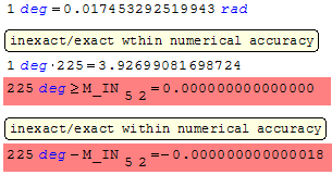

#5 Posted: 5/13/2022 9:44:14 AM
WroteHow can I make these values equal ?
Leave the main matrix numeric, explore Numeric/Symbolic in-situ
The two Boleans disagree ... IMHO, Numeric is the practical procedure.
Cheers ... Jean.
Accuracy.sm (14.45 KiB) downloaded 1557 time(s).
