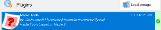

Is it not possible to use the latest version of Maple engine or at least a newer one?
I see that currently version 6 of Maple (released in year 20000, so 24/25 years ago) is used:
I am wondering if is not possible to use a newer version of Maple engine in Smath?

Theoretically I think it is quite possible. But in this case, Maple must be installed in the system separately. The maple plugin must be updated to be able to work with new versions.

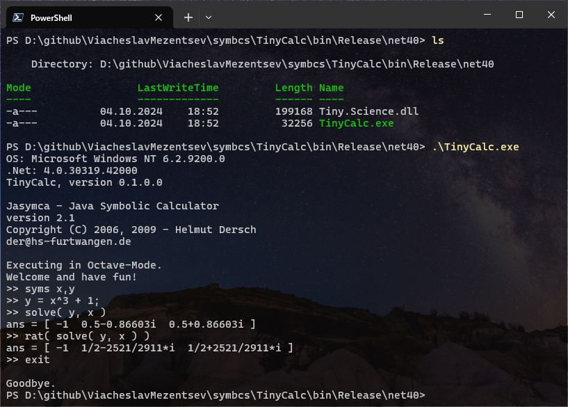

I have my own development for this case, if necessary, I can connect my own port for symbolic engine based on Jasymca.
