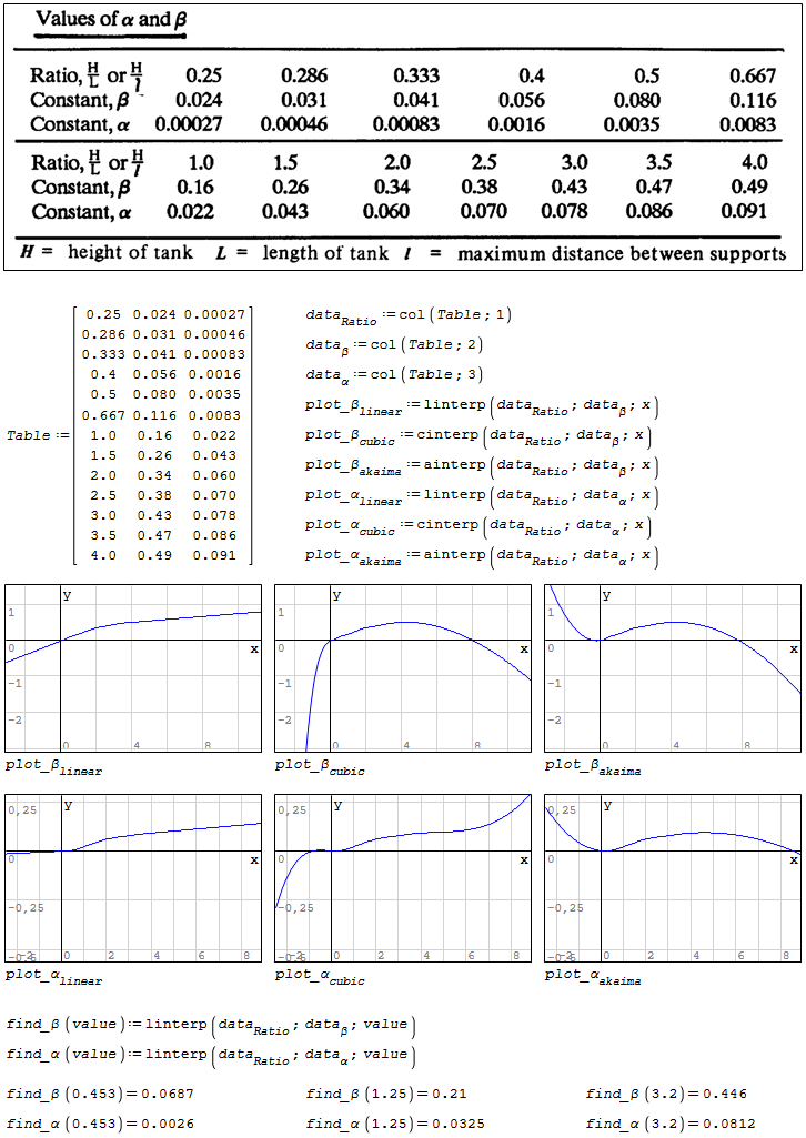

Hi, this is junior school math but what is the best way to obtain any value from a set of data like below? Can this be done on SMath?
Tank Data
The aim is to obtain alpha and beta values from any intermediary values of H/L or H/l.

You can use interpolation functions for that.
There are three different interpolation functions.
Your data seems to be lineear according to values.
Here is a demonstration of interpolation plots.
I also added functions to find β and α.
interpolation.sm (138.91 KiB) downloaded 1168 time(s).
Your data seems to be linear according to values.
Thank you, Overlord. Much appreciated.
