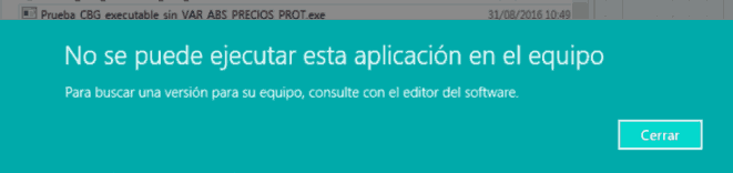

#1 Posted: 8/31/2016 12:58:56 PM
If you protect a region with a password, and this region is closed , to save the "sm " executable ( " .exe" ) Smath Viewer Pro file is not recognized as a Windows executable .
and if you save it as " exe " file Smath Viewer free , the file is saved correctly and is recognized by windows , but there is no way that within the executable , you can open the protected region.

#3 Posted: 8/31/2016 10:03:59 PM
With a simple example, Smath Viewer, stopped working . Annex example
Carlos
