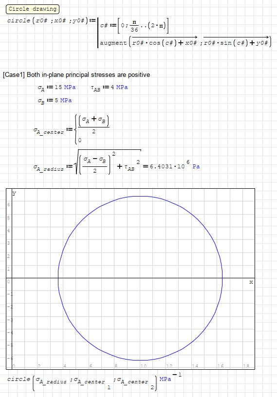

You can make a function to draw circles, for multiple usage on same sheet.
With respect to Ber7, dividing it to MPa will lower the numbers too.
MSS.sm (7.3 KiB) downloaded 1274 time(s).

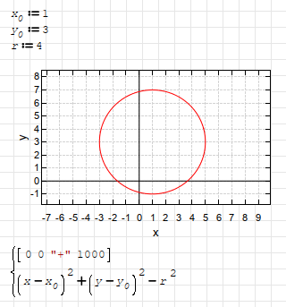

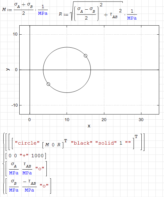

Here is a version with pre-defined geometric object in the XY plot plugin. See Handbuch section 8.3.4.
MSS_Kr.sm (13.86 KiB) downloaded 1274 time(s).
