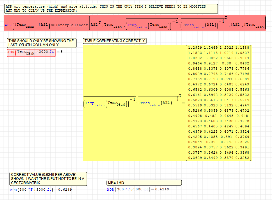

Some direction would be appreciated. This is a function I created and I got it to work straight up; however, I am trying to eventually generate the table (visual cue) and "cherry-pick" the value used in calculations. The values are coming into the matrix, but I'm stuck being required to input the argument as a vector/matrix.ADR.sm (127.5 KiB) downloaded 1201 time(s).

Aaah now I get what you meant.
This should solve your problem.

Is this using the Maxima Plugin? Yes, this is what I was looking to do. I started playing with the Maxima "Solve" feature giving me indigestion. Thank you

InterpBilinear() is in the 'Custom Functions' plugin.
Basically an interpolation with two variable.
Good and useful function.
