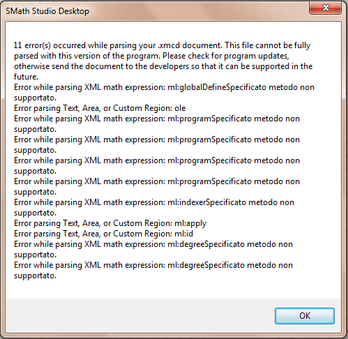

#2 Posted: 10/15/2013 4:58:18 AM
If you use the "file" > "open..." option you should open the file. A dialog show you the errors importing the file, then all other things will be imported (see the attachment)
If in your xmcd worksheet there are things that are present in SMath Studio but are not properly imported post a message in the bugs & problems section of the forum, the author will improve the plugin

![2013-10-15 10_52_41-SMath Studio Desktop - [Page2].png](/en-US/files/Download/Bvk4he/2013-10-15-10_52_41-SMath-Studio-Desktop---[Page2].png)
