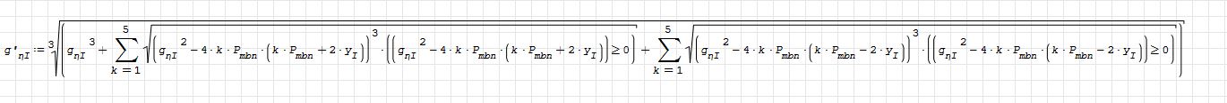

hi Folks, I am programming some equations and there is a requirement for a summation of terms, each term being a square root of a function of several variables. The method requires ignoring any negative results, i.e. where the square root of a negative number will lead to a complex number.
The terms are all have identical variables and it would be ideal if I can perform some operation on the general case term, so that the imaginary results just vanish.

WroteYour description is too general w/o the formula.
Circle Complexn-circles.sm (10.55 KiB) downloaded 1178 time(s).

hi folks, thanks for your contributions
the way I've solved my dilemma was to multiply each term by (X>0) so that whenever X is less than zero the sqrt(X*(X>0)) becomes zero.
Attach the *.sm document.
#10 Posted: 5/27/2021 9:25:19 AM
WroteAttach the *.sm document.
... do some effort:
split that monster, zap subscript, make minimalist like visiting doctor.
Page10 Split Monster.sm (476.26 KiB) downloaded 1407 time(s).
