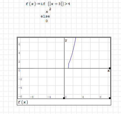

Plot issue?
Plot issue? - Shouldn't this plot from neg inf to -7 and 1 to positive inf? - Messages
#1 Posted: 8/18/2020 12:57:32 AM
PCPlayer24_7
PCPlayer24_7
0 likes in 2 posts.
Thanks for any response - j

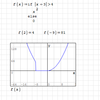

#2 Posted: 8/18/2020 4:30:04 AM
1,125 likes in 1,798 posts.
Hi. Try changing the zoom with the mouse wheel, or it and control or shift.

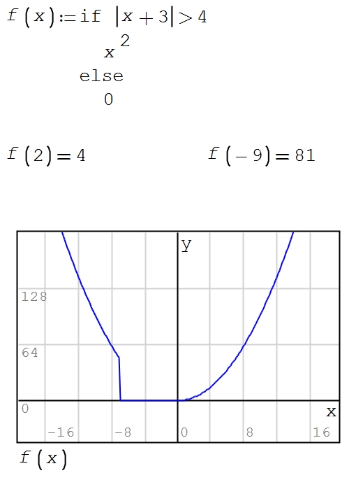

Razonar and Jean thanks for the quick replies, I tried Razonar's suggestion and it does fix the issue! I do like the idea to ensure f(2)=4 and f(-9)=81 to ensure the function works correctly.

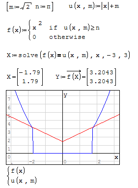

Jean very helpful as well, I attempted to implement your example and haven't gotten it yet. Not sure if this is MathCad or SMath, I cannot get the "if" statement to work as you have it. So far I get only the "if" "else" from the programming toolbar only. The matrix's work though, so hopefully I get your example working in SMath soon.
#5 Posted: 8/18/2020 1:45:59 PM
Martin_B
Martin_B
22 likes in 84 posts.
... I cannot get the "if" statement to work as you have it. So far I get only the "if" "else" from the programming toolbar only.
Try "cases" (Custom Functions plugin).
By adding two, four ... additional arguments, you can add more if statements.
