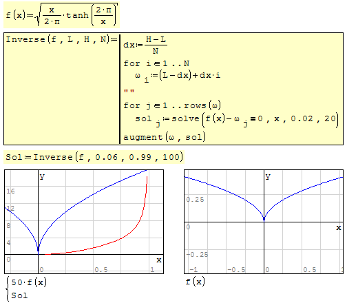

#2 Posted: 1/25/2021 9:04:36 AM
Hi all, trying to get "solve" to work with a function that has a "for loop"
The crux of the issue is this part. Is what I'm doing just not possible?
Plot that function first, then solve.
That will clarify the suite.
upload-question1 Solve.sm (22.01 KiB) downloaded 1130 time(s).

#4 Posted: 1/26/2021 10:03:54 PM

#5 Posted: 1/26/2021 11:39:52 PM
Thanks for the attempt to help Jean, but I surmise from your answer that the particular construct I'm using, which involves a "sign" function, can't be solved using the "solve" function.
I was suggesting a solve bloc within a for loop, your original question.

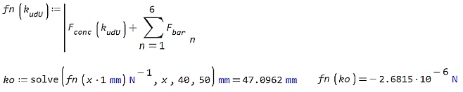

#6 Posted: 1/27/2021 4:33:04 AM
1,139 likes in 1,805 posts.
As shown in the attachment, the function does have a root.
Sign isn't one of the problematic functions for solve (maybe for diff or int, but not for solve). Here is the problem: Mathcad have an special notation for the imaginary unit as 1i or 1j, SMath doesn't. Just change "i" by "n" under your Sigma:
#7 Posted: 1/27/2021 5:40:26 AM
rodp1
rodp1
0 likes in 8 posts.
Raznor - thanks for that! Appreciated.
I managed to solve it a slightly different way - rather than using the explicit summation form, I replaced it with a sum() call. So I didn't need to explicitly define the counter.
