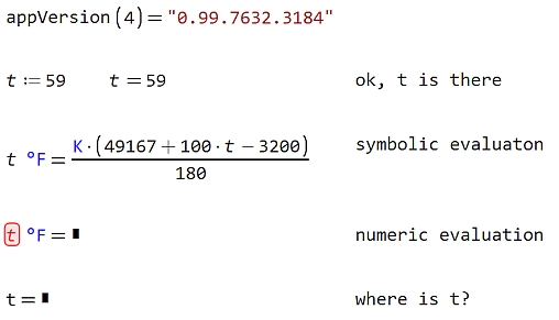

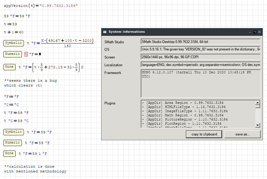

#4 Posted: 12/26/2020 9:20:01 PM
#5 Posted: 12/26/2020 11:59:38 PM
Thanks very much for looking at that Alvaro. I had only tried numeric evaluation- I get the same result as you with symbolic evaluation.
It looks like you are in even worse shape than I am. The variable is still set to the original value for me after attempting to get a Fahrenheit value from it.
#6 Posted: 12/27/2020 8:03:02 AM
#7 Posted: 12/27/2020 9:46:25 AM
