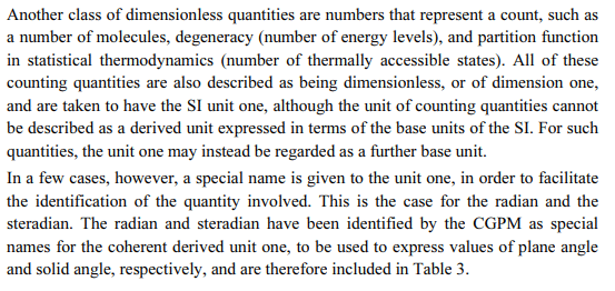

You can start by commenting that the dimension of a quantity is not the same as its units. For example, if I am going to buy paint and ask about its performance, I do not expect them to tell me that it yields three thousand reverse meters but three square meters per liter.
There are specific names for many dimensionless quantities, for instance you can see o lot of them here: https://en.wikipedia.org/wiki/Dimensionless_numbers_in_fluid_mechanics
Radian, degrees and "gradients" (***) are units for measure angles, which "loss" their dimension because are evaluated a quotient of two lengths.
2*Pi*radius is for the entire circle length, not for the arc in the definition of radian.

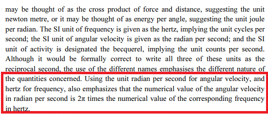

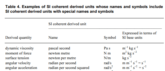

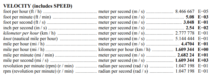

Nope. radian per second it is 1/s. In can't derive that from the animation, check the Official standard, from https://www.bipm.org/utils/common/pdf/si_brochure_8_en.pdf
Pages 119 - 120
Thus, SMath it's correct. Maybe what your friend needs to use is rpm, which have also a correct definition in SMath. It isn't in the BIPM bureau but can find it at NIST: https://physics.nist.gov/cuu/pdf/sp811.pdf
Pages 119 - 120

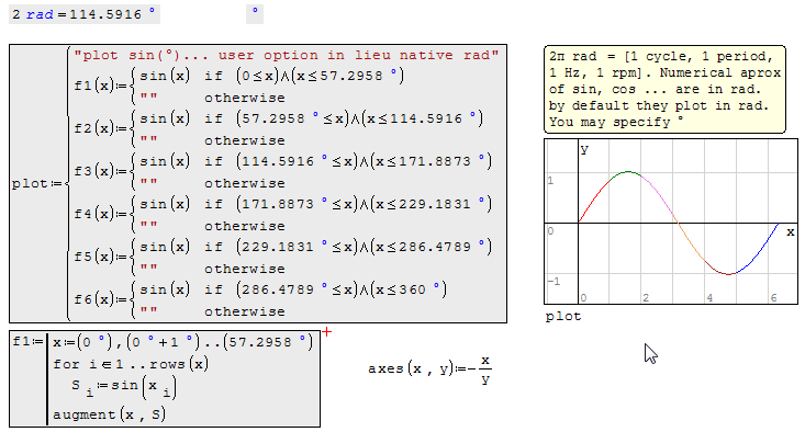

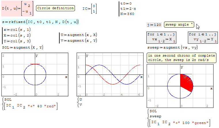

WroteObviously this good man is right radian per second is not the same as 1/s. But what I do not understand is how it is possible that rad is dimensionless but its relation to a second is not that simple?
This question maybe stupid, but I'm not actually a mathematician so please forgive me for this
1rad/s reflects the speed of a flat angular motion [circular/elliptical motion]
More confusing is the numerical approximation of sin(x), cos(x) ...
The argument 'x' is rad.
The visitors may complete the X_Y plot attached.
Maths sin(deg) plot.sm (17.61 KiB) downloaded 1283 time(s).

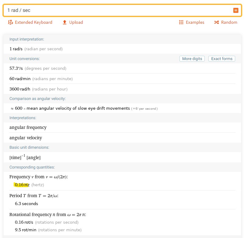

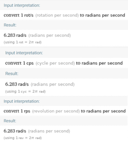

See the line about Hz. Don't we need this in SMath Studio?
Hi. You can introduce definitions for cycle, rotation and revolution. In Wolfram alpha all are the same, but I think you might find this discussion interesting, where my choice for cycle is cycle:=1, not 2 Pi.
https://community.ptc.com/t5/PTC-Mathcad/Curve-fitting-units/m-p/499667
Naming rev or rot as 'rev:=2*Pi you can handle those values that appear in wolfram alpha.
From https://www.wolframalpha.com/input/?i=rot+%2Fs+in+rad%2Fs and similar:

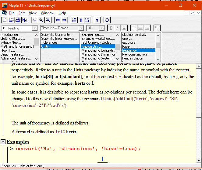

Finally, you can implement more complicate solutions, like this one in maple:

WroteYou can introduce definitions for cycle, rotation and revolution. In Wolfram alpha all are the same,
That's what I have explained above. At least, Wolfram conforms to the ancestors !
