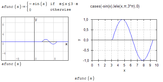

The sample code shows what works and what doesn't. I think the issue is in zed_graph as 2D works. It stops working when the if is added to the function zedgraph example.sm (151.36 KiB) downloaded 1441 time(s).
#2 Posted: 12/21/2019 6:09:32 PM
Seems that Zedgraph can't handle if(). It also fails at non-numeric or undefined values.
A workaround for if() is the use of cases() from Customfunctions plugin. It converts into a boolean expression, which can be handled by Zedgraph.
Suppressing parts of a curve by making it undefined doesn't work. You just can set it to zero.
I am not using Zedgraph. Even setting axes limits requires a lot of scrolling through option trees. XY-Plot is much better in that respect. For log plots I use Maxima Draw regions.
zedgraph%20example_Kr.sm (34.05 KiB) downloaded 1701 time(s).

WroteIt stops working when the if is added to the function
AFAIK, X_Y takes no kind of conditional.
Not needed in two counts:
1. It has axis limits from user
2. plot as data set.
zedgraph example [red].sm (148.78 KiB) downloaded 1248 time(s).

#6 Posted: 12/22/2019 5:24:19 AM
Hi mkraska
I really like the afunc syntax and I am sorry but Newbie I am. How did you get the if after -sin(x)
#7 Posted: 12/22/2019 5:43:33 AM
Hi mkraska
worked it out. types in cases; thank
