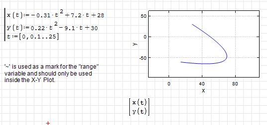

#4 Posted: 10/18/2022 2:53:01 AM
Hi. Just another way, in addition to the solutions offered by Overlord and Pompelmo, using the ability of XYPlot plugin for plot parametric curves, as is explained here.
XYPlot Parametric.sm (5.61 KiB) downloaded 1277 time(s).

#6 Posted: 10/18/2022 6:43:50 PM
Wroteusing the ability of XYPlot plugin for plot parametric curves
Parametric ability is a good addition.
I wish 2D-Plot has this feature too.

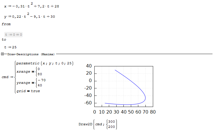

#7 Posted: 10/19/2022 5:17:14 AM
The Maxima plugin provides plotting functions, among them parametric plots. For details look for "kraska smath handbuch".
Note that there seems to be a png export glitch. The region t:=25 is disabled in the sheet but not grayed out in the export (image below). The parameter variable obviously must be undefined, otherwise the x and y expressions are just numbers.
para.sm (137.85 KiB) downloaded 1340 time(s).
