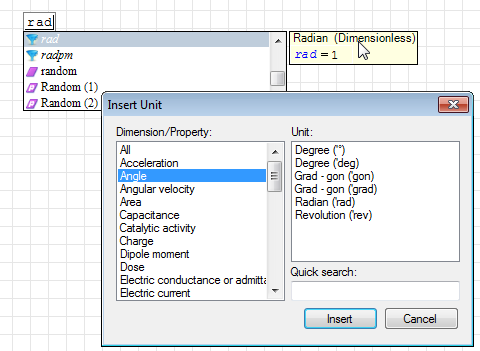

However, not really. The selector box shows the new category, but the dynamic assistant does not.
Here is the custom xml file. place it in the entries folder of the installation directory.
THB.zip (1.23 KiB) downloaded 384 time(s).
