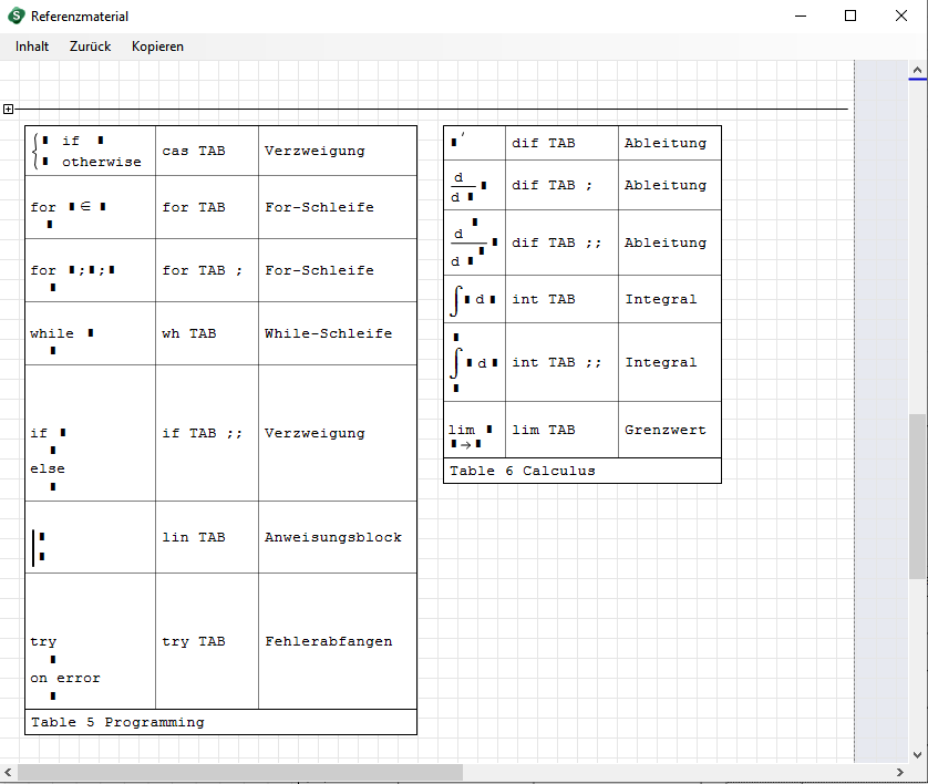

1,359 likes in 2,273 posts.
In Appendix B of the SMath Handbuch you find a list of operators and how to input them.
There is also a snippet "Help" in the online gallery but some entries there are not correctly formatted (problem with Table region).
In the interactive handbook you find these tables under >SMath Studio Documents >Operators and their keyboard input.
The tables there seem to be ok. There seem to be differences between the rendering engine in the reference material window and in the main window of SMath Studio.

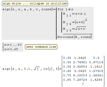

Your very first project may produce an arc region
as exemplified/demo in the attached ... NFG for suite.
As offered, no flaw ...
However, new command line dictates the suite be adapted.
Smath so gorgeous in there !
Cheers ... Jean.
Maths algo style.sm (43.74 KiB) downloaded 1211 time(s).
