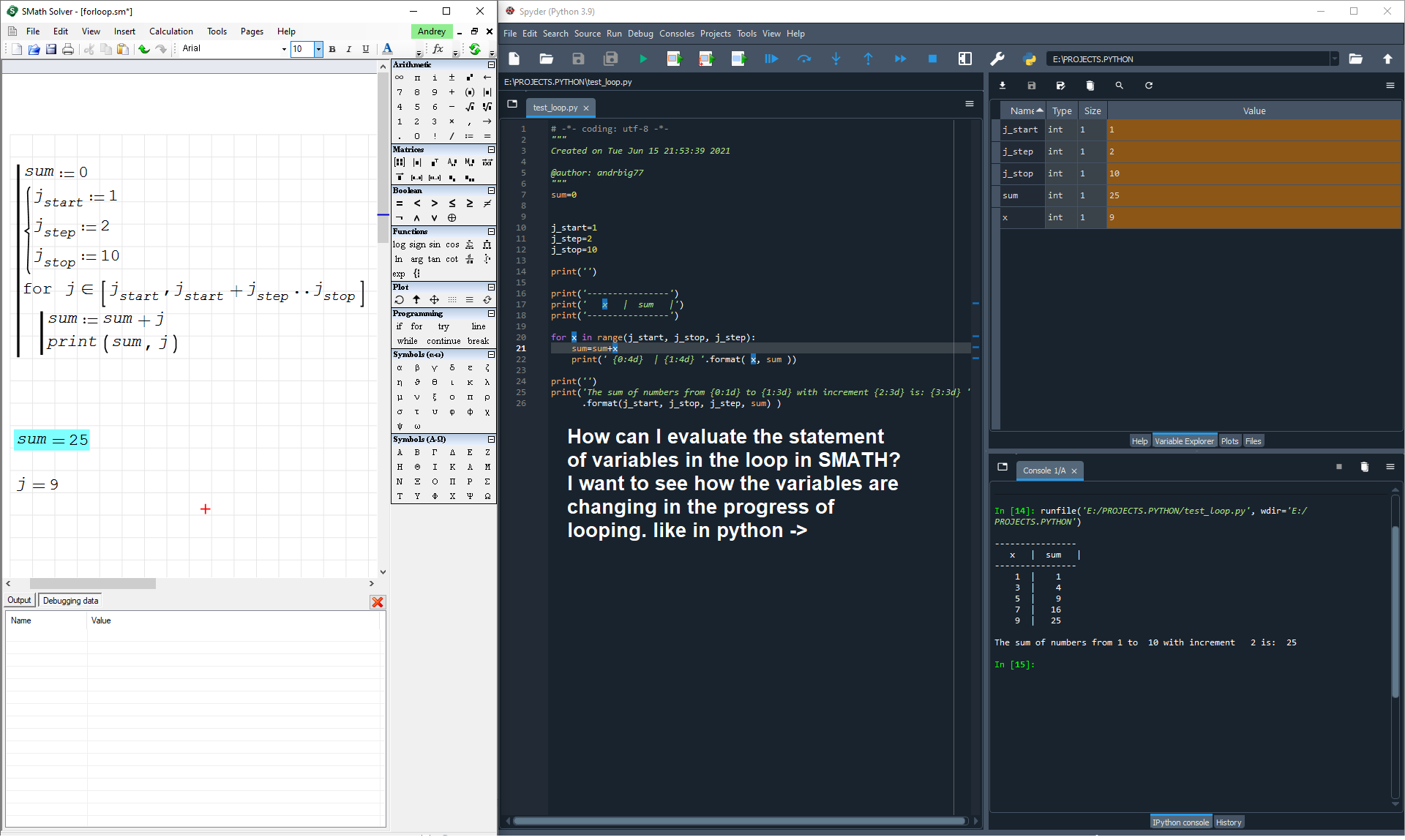

Dear Smath-experts,
How can I evaluate the variables in the loop in SMATH?
I want to see how the variables are changing in the loop like in python.
Is what debug is for, but how does it work?
Best regards,
Andrey

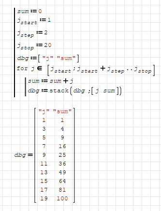

You can see it outside the loop, same more vivid.
Cheers ... Jean.

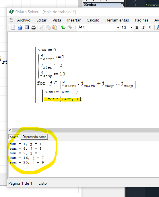

Dear Smath-experts,
Best regards,
Andrey
Hi Andrey, you can use trace() for check how variables are changing in the loop:
Oscar

#8 Posted: 9/11/2021 10:37:47 AM
600 likes in 1,381 posts.
trace() or breakpoints are usually de-facto way to go.
Alternatively you can store variables to a matrix.
