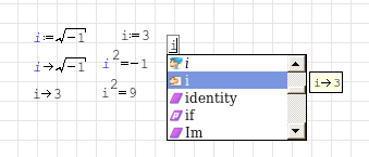

I think would be useful a clear(variableName1,variableName2,...) function.
regards,
w3b5urf3r
sergio 10/19/2012 6:43:00 AM, Oscar Campo 10/19/2012 8:21:00 AM, Radovan Omorjan 10/18/2012 6:15:00 AM

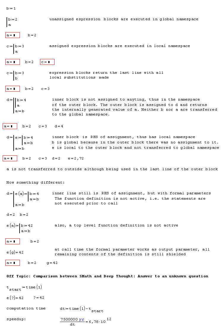

#8 Posted: 12/15/2012 5:49:59 AM
1,361 likes in 2,275 posts.
Hello Rising Eagle,
thanks again for the explanations. I guess this discussion shall get us quite some steps forward in understanding SMath. Seems that we are left with some sort of reverse engineering.
Now here is the first attempt to challenge your explanation for the line function:
I understood that local definitions of names that exist globally will only affect the global variable if that name appears in the last line of the line function.
In the attached example, the global name b is assigned to in the line block but not used in the last line. Still the global value is changed. I see a contradiction between my understanding of your explanation and my observation of what SMath does.
Due to operator ambiguity (please, Andrey, give us back the -> ) I have to mention that all evaluations are set to numeric by default. BTW that is a field of broad discussion in the forum, still with lack of thorough insight (at least by me).
Best regards, Martin Kraska

#11 Posted: 12/15/2012 11:24:56 AM
Here are some tests with the last line of blocks being assignments. Seems that in local namespaces these assignments are ignored and the block just returns the RHS of that assignment. Thus the assignment target is not transferred to outer namespace even if it explicitely appears in the last line of the block.
Also, for me it looks like that function definitions are inactive as long as the function is not called.

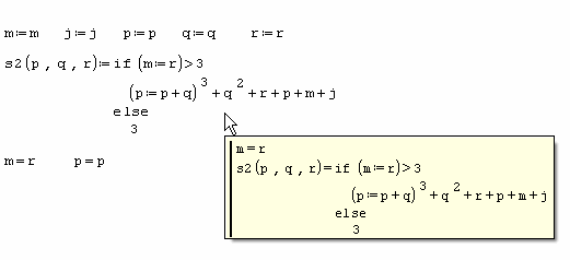

#12 Posted: 12/15/2012 3:18:27 PM
Rising Eagle
Rising Eagle
15 likes in 23 posts.
I might not have been complete in my explanation of the last line of the line function's behavior and therefore must clarify its behavior to remove any unresolved confusion. The last line funnels an expression, not to the general global environment, but to the LHS of an assignment operator in which the line function is the RHS. In your examples 4 and 5 you express a := b. The value of local variable b (not local b itself, nor the value of global variable b, nor global b itself) transfers to the global d. This is correct behavior as intended by the design of the line function in smath. The assignment to a in the last line is treated the same as in any other line in the line function and is therefore a simple assignment to local a, not global a. This again is correct, intended, and consistent behavior.
As you pointed out previously, a free floating line function does not have local variables, so the above behavior does not apply.
In all your examples 1-5, the behavior of the line function is correctly predicted by the rules we have learned from our prior experiences and our recent observations of its free floating use cases.
In examples 6 and 7, the functions d and e(a) are fully and completely defined by a line function on the RHS. If there is activity inside the line functions, it is all executed on local variables and cannot be ascertained by interrogation in the global environment. If we had the ability to use -> or = within the line function environment and have the calculated values show up from within the line function, we could tell. In the end, it doesn't really matter if they are active locally or not. What matters is the global effect. The effect on the global environment is what we must be able to detect and understand. Coming from within a line function that completely makes up the RHS of a function definition, the behaviors of examples 6 and 7 in terms of the effect on the global environment are exactly what we expect.
Function definitions in general do not necessarily contain line functions. Without that shroud, the operations taking place within the function definition are active in the global environment, are subject to the context of activity and variable substitutions prior to the definition, and effect activity and substitutions coming subsequent to the definition. Functions may be complex and contain parts that are globally active and other parts hidden by line functions. But the rules apply consistently to the individual pieces and make a predictable whole. I failed to mention this in my previous explanation.
As for your example 8. Finally, somebody has seen the face of god and brought the answer to the nature of the universe back to us mere mortals. With the mystery now unveiled, the stars will burn out one by one, eventually leaving a dark and physically lifeless, but fully spiritual universal existence in its wake.
Thank you for the insightful discussion and lucid examples so far. I look forward to more.
I must say, I am impressed by the caliber of the members of the smath community and the remarkable advancements in its development and applications over the past few years. My hat's off to all of you.
Martin Kraska 12/15/2012 6:35:00 PM, Radovan Omorjan 12/16/2012 2:48:00 AM

Some quick answers:
symbolic evaluation - do you mean what are the rules for substitution to construct formulas that are defined or how does it do algebraic manipulations to simplify expressions? In the former, I believe I understand the basics, but now see from your examples that there are structures I have not used extensively enough to have seen the deeper patterns. We have already discussed some cases and we will get a couple more tonight. In the latter, I find the smath algebraic simplification quite lacking, even disappointing. I try not to use it without proving that its results are correct. If you refer to -> vs =, my understanding is that = only works if all variable dependencies in an expression have a numerical value assigned to them so that a number can be calculated. -> allows variable dependencies with no numerical value assigned to it and the display string will show those unvalued variables in relation to numbers already calculable in the rest of the expression.
eval() - never use it. Never needed to in my work. From reading, it forces immediate numerical substitution and calculation and cannot work if one or more variables do not yet have a numerical value assigned.
formal parameters - this is the basis of our current discussion. We will uncover their secrets.
imaginary unit - don't know full explanation. In your for loop, the i is a local variable and does not exist as a global variable, therefore, it cannot supersede the default imaginary number i. When global i is assigned anything other than the imaginary i in the global environment, the i becomes a global variable of a new type and the new definition of i with the new type that goes with it does supersede the default imaginary unit i.
active definitions - this is my term. I refer to function definitions of math formulas in the conventional sense without the use of line functions or other programming structures. I do not think of the line function when I think of a math function with parameters; this combination is a programming extension offered by smath. This combination is important to explore, however, and your list of examples begins that process, though, I don't believe any of them actually contradict my understanding of the two separate structures when I think of how they would behave when used together. My two original explanations assumed math functions with parameters and line functions as mutually exclusive and separate concepts. In your thinking, they are fundamentally linked. To me, for example, a math function is f(x) := x^2 +1.
I mean active in the sense that if you embed assignments, e.g., f(x) := (m := x)^2 +1, then the global variable m is assigned the symbolic substitution of global x which shows up subsequent to the definition. The formula, on the other hand, uses the local value supplied by the function argument parameter (into a local variable x) from the function call. Consider:
m->m, x->x
f(x) := (m := x)^2 + 1
m->x, x->x
see how the embedded assignment assigned global x to global m and this is just the definition. Also
m->m, x->22
m->22, x->22
again see the global assignment, even though the function has never been called. This is what I mean by active definition. The evaluation of x^2+1 cannot, of course, be evaluated numerically since there is no value for the local x substituted in with a function definition. Evaluation only occurs when parameter is supplied in a call to f(x).
A subtlety here is that when smath parses the definition, it recognizes the global assignment instruction and that it is independent of the formula and takes the action right away and removes it from the formula used to calculate f(x) when f(x) is called subsequently so that the global assignment is never called again.
m:=4, x:=15
f(3)=10
m:=4, x:=15
In your for loop/trace example, the i is a local variable and no parameter argument is supplied to occupy local variable n, so the loop cannot execute in the definition. In fact, smath goes further and makes it a syntax error if a numerical value is directly used in the for loop range in this example of a function definition (this syntax error does not occur if the for loop is free floating, but only when it is in the RHS of an assignment operator).
Now consider a more advanced function:
m->m, j->j, p->p, q->q, r->r
s2(p,q,r) := †if (m:=†r)>3, (p:=†q+p)^3+q^2+r+p+m+j, else 3
m->r, p->q+p
dynamic assist shows the function defined as s2(p,q,r)->if (r>3), 2*r+p+j+(p+q)^3+q^2, else 3
Here, from the definition provided, smath performs several operations. The embedded global assignments occur for m and for p which take effect in the global environment subsequent to the definition. See from the formula how smath constructs the function and it has been stripped of these assignments. These global assignments occur only during the definition of the function and are not carried out during any call to the function. Any algebraic and/or numerical simplifications and optimizations that smath is able to do in advance for the function occurs immediately when it parses and reconstructs the formula in the definition. These are all part of the active definition feature of smath. Recap: each assignment occurs in two ways. The assignment is interpreted as a global operation with global variables and values. Global operations occur only during definition of formula and not in subsequent calls to the function. Each assignment is also interpreted as a local operation with local variables and values; their effect (and any other possible optimizations) on the formula expression is applied immediately by smath during formula definition. The algorithm for making local substitutions is basically sequential in order of their appearance in the definition syntax and applied to subsequent instances of the variable to be substituted in the formula definition. This algorithm in smath is flawed if circular assignment definitions are attempted.
A circular example for you to play with:
s2(p,q,r) := †if (q:=†r+p)>3, (p:=†p+q)^3+q^2+r+p+m+j, else p:=3
p->6+r, q->6+2*r, r->r
dynamic assistance shows: s2(p,q,r) := †if (6+2*r)>3, 3+r+m+j+(6+r)^3+(3+r)^2, else 3
After playing with this function, you will see that if there is no circular references in the assignment statements, the substitutions are sequential and make sense. Circular references cause screwy results from the smath parser, however.
If you still have questions about the line function (a facility for writing mini linearly sequential computer programs within smath and which may be used to define complicated functions) please ask. I'm not sure what is the cause of any confusion.
#15 Posted: 12/16/2012 10:59:02 AM
Thank you again for the interesting contribution. Responding to all of the aspects will take some time, therefore I just take some of them.
If the formal argument n has a value or not does not affect the definition. You see that in the first section of the attached example. Still the loop is only executed if the function is called.
Thanks for explaining the term "active definition". My understanding is now: "A definition is active if embedded assignment operations are executed at definition time". Correct?
BTW, I never would have guessed that "for" or perhaps also other flow control structures create their own name space. At least, the iterator variable is local as long as it is not used in embedded assignments. To my taste this is one more time too much implicit scoping in SMath.
However, its different modes (numeric, symbolic), myriad structures (function definitions, line functions, for loops, etc), myriad operators (->, :=, +, -, ^, etc) make the set of rules complex and the effort to reverse engineer protracted.
Perhaps we have to add also differences in the program versions, as I fail in reproducing some of your observations.
Worst of all is the lack of the -> operator in recent SMath versions. The operator is available but is displayed as "=". Thus you cannot judge the evaluation mode by just looking at the doc. There have been discussions on what the effects of symbolic/numeric settings for functions at definition time and at call time are. Our recent discussion has really shed some light on that as well, might be worth revisiting those old examples.
for loop and function.sm (13.07 KiB) downloaded 1469 time(s).
m->r, p->q+p

imaginary i is reserved and smath confuses itself as explained below
suggestion: use the unicode i with macron
ī:=sqrt(-1)
After this assignment Smath suggests ī whenever the user presses i

Thank you again for sharing the results of your reverse engineering research. The length of the posts in this topic seem to follow an exponential law. I am asking myself if we are not in a situation where we use SMath to solve problems that we would not have without it.
For me, the right balance between joy and frustration is controled by how deep one digs. Therefore I try to be pragmatic and just limit the search to structures and procedures that we definitly would have a benefit from, should they work reliably.
Things like embedding assignments whereever SMath fails to complain, are beyond what I want to practice and teach. I admit that such experiments are good challenges for assumed rules, but I would try to limit the use cases.
Top level requirement is that things should look and work like handwritten formulas and algorithms on paper. So what are the expectations to handwritten code?
- Variable scoping should be controlled by entities like function or procedures with well defined input and output rules.
- flow control statements like while, if, for, line shpuld not interfere with variable scoping.
- Visual representation and internal handling must allow to tell imaginary unit from variable i. A math program should allow for safe use of i as variable in loops without spoiling complex calculus.
- Everything must be unambiguous, such that you can reproduce everything from printout. An example is the difference between name indices and adress indices. These can be identified by the amount of space. This is not always (never, so to say) obvious to the uninitiated but safe once explained. We had more serious issues with sums and their arguments.
Some of these expectations are still not possible to meet. Others are possible to meet by choice of the autor of the sheet. Best case is where SMath enforces the sheets to meet these expectations by complaining in case of non-safe usage (this sometimes happens in matlab).
The final result of reverse engineering should be a minimal set of survival rules. Examples:
"Never use i as variable name"
"Never use symbolic optimization"
"Never use 3D diagrams"
"Never rely on local scope of variables"
"If in doubt (or better always) press the re-calculate button"
"If the formula could be misunderstood, set braces, even if SMath does not require this"
"Never embed assignment operations except in the body of control statements"
The better the program becomes the less such rules are required.
ī:=sqrt(-1)
This is good information. Once the preassigned value of a default symbol is assigned on the smath sheet to another symbol, the default symbol can be reassigned in any other way and used as desired. Definitely good to know.
I have an alternative to your suggested reassignment: i is the imaginary unit. As a unit, it should be treated as such and assigned to a blue character. Just type:
'i := i
PS - I would like to use italics. I could use a cut and paste from a character map, but I would rather use a ctl-key that works in the same way the ctl-g key transforms a roman letter to a greek letter. If anyone knows how, please reply. It's interesting, the blue i shows up in DA as an italic, but as a regular roman character on the smath sheet.
