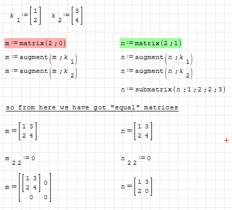

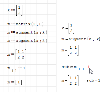

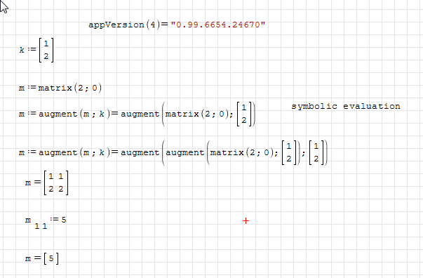

Hi, what am I doing wrong?
m matrix looses it's contents and dimensions after I assigned a single element.
Edit: I found an ugly fix. First I have to create matrix of (2;1) instead (2;0) elements. After all augmenting I have to use submatrix to get rid of first column.

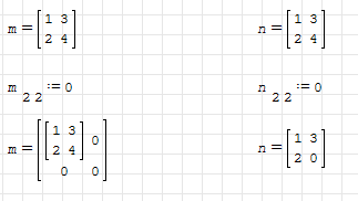

#2 Posted: 3/22/2018 1:04:56 AM
Just like this.

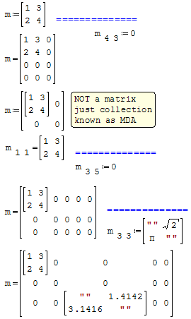

#3 Posted: 3/22/2018 1:49:29 AM
CBG
CBG
78 likes in 312 posts.
Something like this?
Ass_elem_Matrix.sm (4.52 KiB) downloaded 995 time(s).

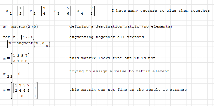

Ok, I probably did not clarify my real needs.
I have some matrices. I just exclude single column from each of them and then I glue them together.
So in my real sheet I never glue the same matrix twice.
Here comes another example where I try to augment some vectors to new matrix.
I have many vectors and they are indexed so I can use program to augment them in a loop.

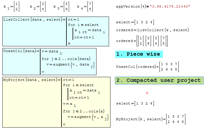

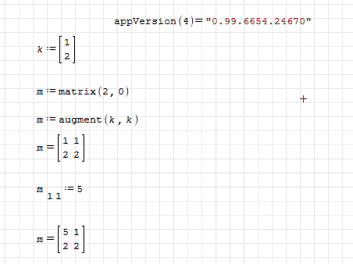

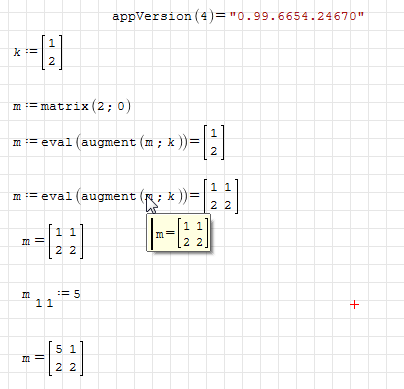

#5 Posted: 3/22/2018 8:08:01 AM
1,361 likes in 2,275 posts.
The issue is in the type recognition on the left hand side.
m is a matrix-valued expression rather than a matrix (expression with mat() being the top level object). We had this already with index values being expressions instead of variables.
Thus, the existing m is not recognized as a matrix and therefore not modified but overwritten.
You need to make sure that m is actually stored as matrix, i.e. by applying eval() or by just evaluating numerically (you did symbolically)
I'd prefer SMath to actually check if m evaluates to a matrix and then deciding what to do.
Ass_elem_Matrix_Kr.sm (5.67 KiB) downloaded 942 time(s).
Davide Carpi 3/22/2018 8:16:00 AM, sergio 3/22/2018 9:00:00 AM
#6 Posted: 3/22/2018 10:21:30 AM
That will handle your projects more conveniently.
Poland.sm (15.33 KiB) downloaded 953 time(s).

#8 Posted: 3/24/2018 7:01:20 PM
The flaw is that m is not evaluated before applying the by-element assignment.
you can, however, enforce this by setting the previous two assignments to numeric optimization in the context menu.
This complies to the survival rule "never use symbolic optimization unless you know what you are doing".

#10 Posted: 3/26/2018 5:10:28 AM
m227
m227
4 likes and 1 dislikes in 29 posts.
Your solution works, it was enough to set it for first assignment. I have to comment it in code at least. Thank you.

#13 Posted: 3/26/2018 11:23:55 AM
So I have two matrices in front of me (see screenshot)
Your original 'm' is a matrix.
Your concluded 'm' is NOT a matrix, simply a collection.
You can't apply any matrix calculation.
Make it a matrix and continue the project.
