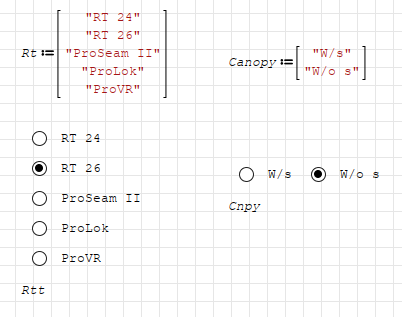

Hi!
I am having trouble on the RadioButtonList. When I use " " and "/", it turns into \0020\ and \002F\.
On this list:
its supposed to say: "RT 24", "RT 26" and "ProSeam II" as you can see on the source:
Also on this list:
its supposed to be "w/s" and "w/o s" as it was defined on the source:
Do you know the way to fix it?
Thank you!

Sorry I was on mobile yesterday and I've assumed it was a missing fix.
I cannot reproduce on windows too. What SMath Studio and plugin versions are you using?

I am using Smath version 0.99.7822 and RadioButtonList plugin 1.0.7784.26230.
In a new one, I already try but here is the error again:

Latest plugin version for your SS should be 1.0.7831.2550. Please check in Tools > Plugins... For the bluish plugins there is an update available.

It works now!
Thank you so much!!
