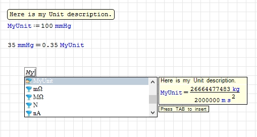

Hi. I agree with Martin. Also, in the standard way to introduce new units in SMath, you can add your own unit description, again, in the standard form.
I don't check if you can add different description for different languages.

So my question is, what am I doing wrong? What do I need to do to get Smath to accept my additional unit descriptions?
Simply do not reference the *.lang file; that is: do not specify an 「id」. Instead, I would advise you to just declare a 「title」 field.
If you inspect the 「Constants.xml」 file, you will notice the constant "ε.0" does not reference an id, but just defines a 「title」 of value "Vacuum permittivity"; the 「title」 field IS the value that is displayed as the SMath unit description.
    <add factor="8.85418781762039" exp="-12" connection="{A^2*s^4}/{kg*m^3}" [h]title="Vacuum permittivity"[/h] lang:rus="Электрическая постоянная">
