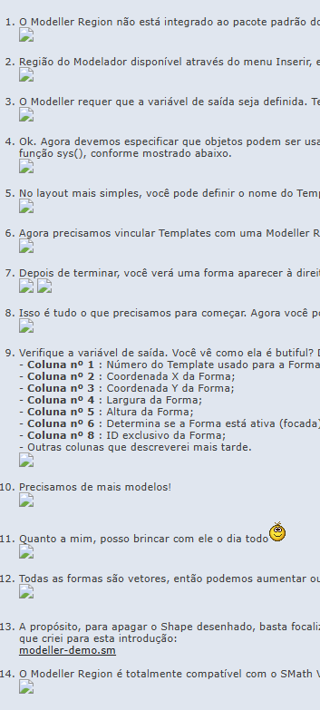

I can't find any tutorials, videos, texts or even images on how the modeller region plugin works.
#2 Posted: 12/10/2024 4:56:16 AM

official thread
Captura de tela 2024-12-09 190839.png It would be interesting if the images appear
#4 Posted: 12/10/2024 4:56:59 PM
1,443 likes in 2,936 posts.
Indeed, seems a problem in the forum attachments.
There is a working video linked in post #12.

Weird. The link takes me directly to the smath studio download page
#6 Posted: 12/11/2024 12:20:44 AM
Sorry, I was in a rush. I meant the post #15.
Link in post #12 has the same issue of the images, I think.
There are also a couple of examples in the SVN and in the gallery (Colors of the rainbow).

The link in post 15 doesn't work either, at least not for me. Thanks for the SVN examples, this one works.
#8 Posted: 12/17/2024 1:50:18 AM
That's strange, it prompts the download of a video (wmv) for me.
Just for the info: I've just recorder a small demo: http://smath.info/file/yLAXA - it shows how to start using Modeller in few steps.
Here you can try with this link (re-uploaded): ModellerDemo.wmv (3.28 MiB) downloaded 719 time(s).
