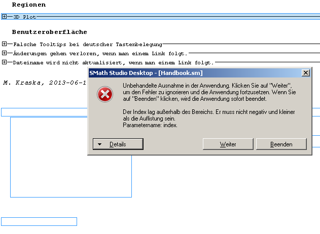

Using Ctrl-Drag to copy a closed region crashes SMath.
You can just save the (spoiled) work, but no further editing possible.
Edit: Seems to be fixed in 0.97.5189
#2 Posted: 6/16/2013 9:24:47 AM
I noted that that the closed Area region can not be moved, and I took that as granted. The CTRL+Drag of closed Areas scrashed SMath, that I can confirm as well.
