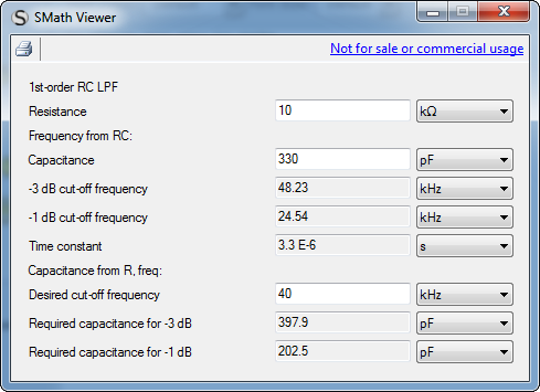

It's possible to make two converters, like this, one that calculates A from B and one that calculates B from A:
But is there any way to make a converter where changing any input updates the other inputs? So there's only one instance of A and one instance of B, and changing either of them updates the other? It would behave similarly to this:
https://www.analog.com/en/design-center/interactive-design-tools/dbconvert.html
In this converter, if you change any of the text fields, the other text fields update to match it.

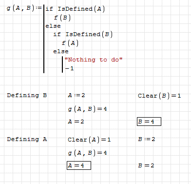

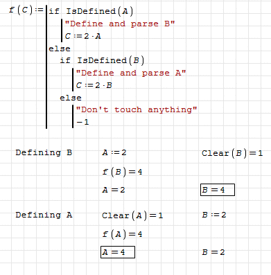

#2 Posted: 10/30/2018 2:56:07 PM
Hi. Something like this?
or
AfromB_or_BfromA.sm (13.01 KiB) downloaded 1189 time(s).
or

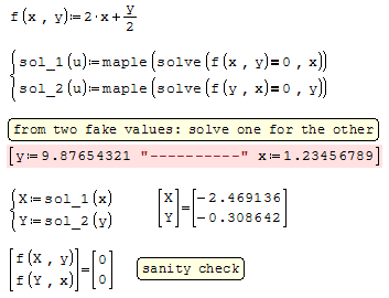

... these two are real projects mutual solving dependencies.
Solve TREASURY_1 [Iterate L, Lc].sm (42.63 KiB) downloaded 1076 time(s).
