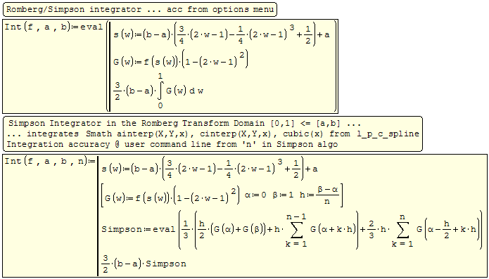

#10 Posted: 8/14/2019 7:07:51 PM
As you can see, Romberg has the virtue of reducing the range of integration
in the [0 ... 1 ] domain. In two versions directly associated with the
Smath native Simpson integrator or Simpson algo style, thus integration
accuracy 'n' @ the user command line.
These two documents are like minimalist tool box.
Integrate Compendium_1 Romberg_FD_Adaptive [Carlos].sm (142.88 KiB) downloaded 879 time(s).
Integrate Compendium_21 Simpson-Romberg Merit.sm (138.06 KiB) downloaded 991 time(s).
