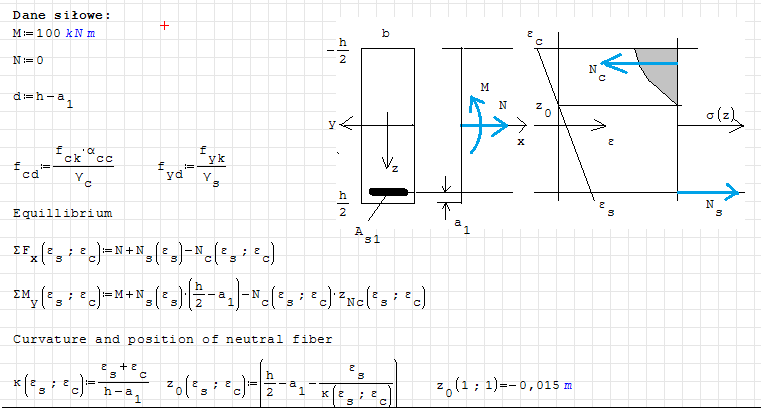

In my previous topic I was struggling with getting properly built equations.
Right now, I have prepared document, where I am looking for two unknows, basing on set of two equations. Can anyone take a look and help me to solve it? (attachment)
BR.
Strain_stress - SMath forum.sm (31.74 KiB) downloaded 1443 time(s).

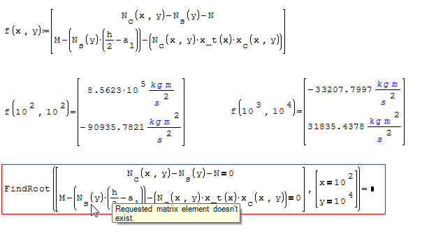

#2 Posted: 3/7/2017 1:21:24 PM
Few points:
1. The unit system is such a pest and never needed because maths are "unitless"
I have removed it in the attached.
2. If there are solution(s): it is "FindRoots"
3. For the system to solve: you must confirm in some way
that the system is solvable. I don't think it is solvable.
Our friend Radovan is "guru" in that stuff.
The "Quaternion" is added to prove "FindRoots" works when solvable.
Strain_stress - SMath forum Copy.sm (44.14 KiB) downloaded 1345 time(s).

#3 Posted: 3/7/2017 2:40:07 PM
Why do you insist on defining the stress-strain behaviour using if statements?
And why do you split the domain of integrals? The numeric procedure doesn't need that.
Accuracy only benefits from splitting at steps (which you don't have).
So, unfortunately, the sheet looks much more complicated than actually required.
I already did simplify the functions and showed how to solve the system in this post. What was bad with that approach?
@ Jean: Units are an essential part of engineering documentation and language. It is a matter of efficient communication. Please respect that if you want to help.
I would not mind you opening a separate topic "War against units" and post there as much as you like. This could even lead to a fruitful discussion. But please resist the temptation to raise this issue where it is off-topic (e.g. in topics started by engineers). This would contribute to a better SNR in the forum.
Martin

Could you explain me what have you done in that "check" and what was you looking at?
I attach general rules of the method. Maybe I have some mistake hidden in equations? Solution should exist.
Strain_stress - SMath forum.pdf (522.3 KiB) downloaded 804 time(s).

I might be wrong in this particular case but, in SMath if you have some equations with integrals, if statements, logical expression, absolute values etc. (some kind of discontinuity, or some other more "wierd" stuff) and want to solved them in a strictly numerical fashion ie. find the roots of the system, or to use some optimization procedure...you are doomed. Besides the possible non existing solutions (Martin pointed that out), SMath can hardly cope with this. I struggled with some similar problems and gave it up.
#8 Posted: 3/8/2017 9:45:15 AM
Wrote...and want to solved them in a strictly numerical fashion ie. find the roots of the system, or to use some optimization procedure...you are doomed
How can I solve that otherwise? Is there any different way to get results (more or less accurate)?

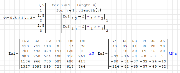

#10 Posted: 3/8/2017 2:45:49 PM
I tried to setup the procedure in an slightly alternative way and tried several ways to represent the stress-strain curves (cases, linterp, abs)
There may be errors in the equations, but this is just how far I got, just to understand the mechanical problem.
The equations fail to be solved using roots(). Also Davides functions can't handle the integration variable, which unfortunately is blamed to be unknown.
I guess, an option would be to provide analytical expressions for the stress resultant and it's centroid. For trapezoidal shapes that should be pretty easy.
Reinforced-beam.sm (311.79 KiB) downloaded 1358 time(s).

At this moment I want to solve equation, where I have given design moment (M) and axial force (N). The results I want to get are strains in both concrete and steel.
You are right that I am not calculating resisting moment right now.
The next step will be to get all possible moments (M) and forces (N), where strains are given to prepare so called interaction diagram N/M. Result below.
The formulea is true only when Eps.1>=Eps.yd=fyd/Es and Eps.2>=Eps.yd=fyd/Es - we can use M.Rd (6.30).
Otherwise then in equation we have to use correct value of stress σs=Eps*E.s and σc - then we may use the same formulea (6.30), but instead of fcd and fyd we will have fcd(eps.c) and fyd(eps.s).
I don't know if it is clear for you, if not please do not hesitate to ask.
I am still looking for solution of that problem.

WroteAlso Davides functions can't handle the integration variable, which unfortunately is blamed to be unknown.
Quite right Martin,
Mathcad 11 would not solve either because the integral is not a continuous
analytical function. Easy to cope via discretising the integral.
Finite differences is exceptionally valid for the remaining of the project.
There may be an alternate route via the "incremental companion". Not tried
because eventually the project must end to an export data table solution.
This project resources to many Smath great maths.
"Genfit Solve Martin" is attached so that nothing comes out of the blue.
