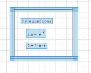

Is there a plugin or an easy way to draw bounding boxes?
The only way I have figured out, is to create a text box filled with spaces and newlines and set color and bounding box to it. It helps me to group variables and organize notes. This approach is somewhat tedious. Is there a simpler way? Would it be a good idea to create such a plugin?

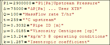

You can group poroject parameters, anotate ... simply.
Highlight as you wish, click to border. All the parameters
in this example are active for the next project procedure.
For that special bracket: click in palette at right to get
the first pair, click on the lower place holder, press
coma, coma, coma ... to add more. Put more instructions
in a separate text box. Will that do ?

This is a rather nice possibility I haven't thought. Would it be difficult to make a plugin for a drag-to-resize box? This would give even more freedom.

I cannot imagine it being possible to create a stand alone bounding box, unless it is an empty region that will get selected on click.
Approach proposed by Jean is probably the most straight forward one.
If you insist on resizable bounding box (empty region) you can insert an image region, turn on the border, uncheck display input. This will LOOOK like what you are asking for, but will not have the desired functionality.

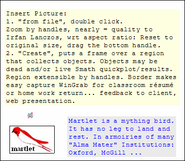

Don't need a plugin, use the Insert => Picture => Create.
It plugs a box with handles ... stretche each direction.
To view the bounding box: click on the square in the menu,
slide over your collected stuff: text, image, equations ...
Click anywhere in that creation, the inside stuff disappears,
stretche with the handles, click away outside, bingo the
all creation is back.

This is another, actually rather functional trick. Yes, the Picture region plugin allows to paste pictures directly to the worksheet and scale them by dragging. When cutting single color area from the screen and pasting the picture to the worksheet, the functionality is very close to what I was thinking. The only problem in this approach is that you cannot put regions to the background in SMath. That means that if one wants to edit the regions inside the bounding box, one has to move the box away. Is there a way to define regions for "background"?

AFAIK is not possible to create a plugin to draw hollow regions (BTW, was requested to me also for the snapshot region). This would require some new core features from the developer.
In addition to the suggestions above, you can create your own "horizontal line" and "vertical line" from any paint program (f.e. MS paint), "big enough" to be close to the page size to avoid resize artifacts), then you can copy and paste them in the worksheet and resize to the required size.
