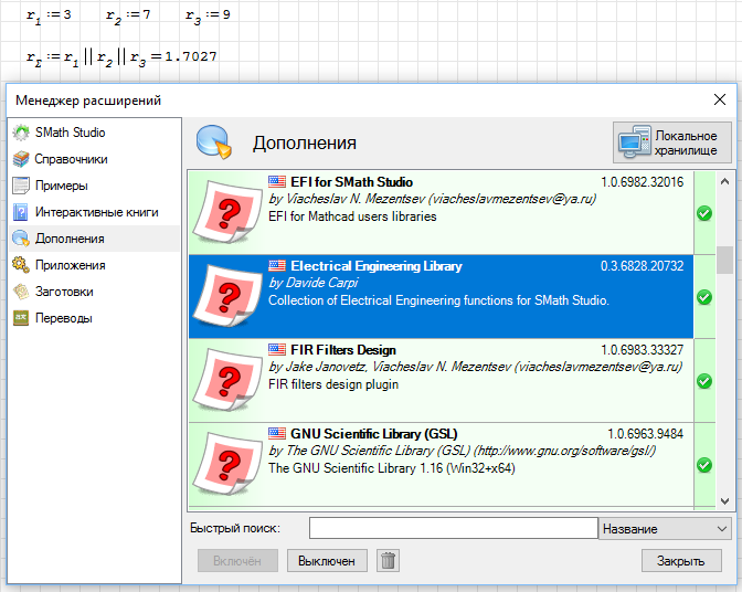

Hello,i have r1=3 r2=7 r3=9
is the some operator that will do the parallel operator?
1/rt =1/r1 +1/r2 +1/r3
Thanks
#2 Posted: 5/29/2019 7:45:11 AM
1,542 likes in 1,856 posts.
EEL_Rpar() function from the Electrical Engineering Library:
r.Σ:EEL_Rpar(r.1,r.2,r.3)

Sorry, I don't understand parallel operator.
This operator let's you calculate the total resistance of resistances in parallel
Arie 5/31/2019 12:00:00 PM
#6 Posted: 5/31/2019 11:59:35 AM
Arie
Arie
94 likes in 285 posts.
More explicitly...
