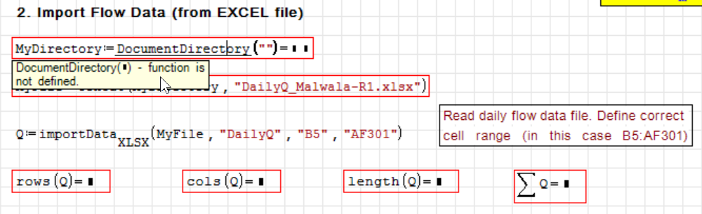

However, I get an error "DocumentDirectory(.) - function not defined", when trying to import an EXCEL data file.
Several attempts with clean reintallations did not work.
The SS file and Excel data file are attached.
DailyQ_Malwala-R1.xlsx (84.85 KiB) downloaded 884 time(s).
Test.sm (94.18 KiB) downloaded 1228 time(s).

Confirmed. My fault. Will fix later today.

Fixed. New beta version released.
