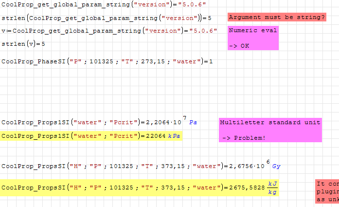

Nice work
My experience with numeric interface is limited to a couple of plugins, but I've not noticed obvious errors; therefore I've tried a "mixed approach" like in the GPCWrapper (code written with numeric library and I/O handled with lowlevel evaluation) and as you can see from the attachment this works fine, thus the core of your work basically it works (and the issue probably is in the IPluginMathNumericEvaluation.NumericEvaluation, or maybe we are missing something else...)
The implementation is a little bit naive, just to make the test
- input arguments are not preprocessed (overriden with values taken from your debug file)
- units in some cases uses new MItem() instead of unit(uname()) (this approach seems better but I don't have idea if it works with localizations)
![2015-02-12 11_50_39-SMath Studio Desktop - [debug.sm_].png](/en-US/files/Download/x6hkeh/2015-02-12-11_50_39-SMath-Studio-Desktop---[debug.sm_].png)

Thank you Davide!
I seem to have solved the units problem.
Unfortunately, the new MItem(string) doesn't handle localization; thus I had to keep using the long way.
It turned out that it is crucial to call Expression.SimplifyEx() upon MItem. And taking into account that there's no context in numeric evaluation available (or I miss it), I had to split all the units to basic SI parts (e.g. Pa -> kg/{m*s^2}). Then the units work as intended, and localization works.
The second problem (text that is "not text") seem to be over my skills; hope that someone could shed some light there.
Other than that (unimportant?) issue, the plugin is ready to use. I post the source here, in case someone could make some suggestions.
