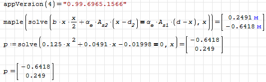

Hello, maybe someone could help, then I solve the equation with symbols it doesn't solve (I've attached the file), when I make simplification for my self it solve:
example p:=solve(b*x*x/2+a*As2*(x-d2)=a*As1*(d-x),x) it says no real roots
then I simplified by mysef
p:=solve(0.125x^2+0.0491x-0.01998=0, x) it give answer?
best regards,
Paulius

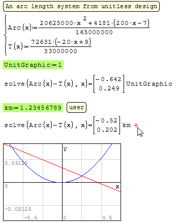

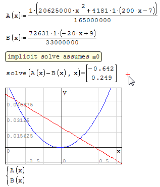

1. recast the functions unitless
2. plot
3. solve implicit in this case.
Davide Carpi 1/28/2019 5:53:00 AM

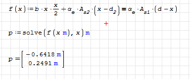

Hi. You need to handle units in the SMath solve function. Here it's a way.
4 users liked this post

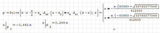

Solve() from the Maxima plugin can handle units directly (symbolic solver)
2019-01-28 14_26_49-SMath Studio - [Gelzbetonines%20konstrukcijos%20ilinkio%20skaiciavimas.sm_].png
frapuano 1/28/2019 12:57:00 PM
