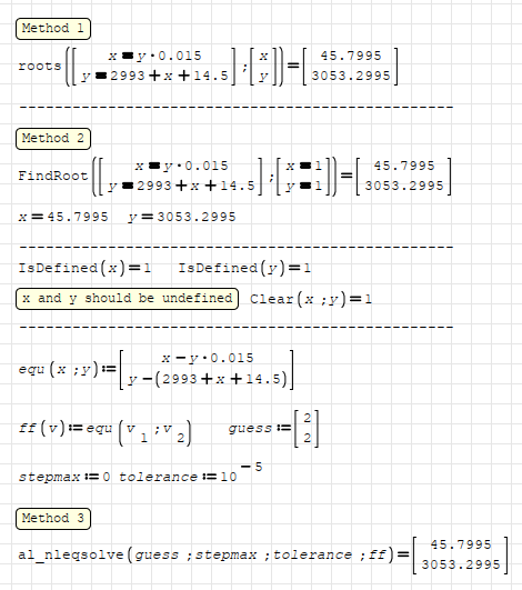

#2 Posted: 1/1/2022 7:59:32 AM
600 likes in 1,381 posts.
how to get the result of x, y without using the matrix? I tried solve and findroot, but can't get the value of x, y.
You can't use solve() for nonlinear equations. (more than one unknowns)
You can use roots(), FindRoot() or al_nleqsolve().
Here is your equation solved in various ways.
solvers.sm (10.77 KiB) downloaded 1300 time(s).

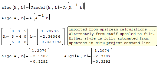

#3 Posted: 1/1/2022 10:17:57 AM
how to get the result of x, y without using the matrix ?
Matrix style is more commonly encountered in Engineering projects.
That add-on will enrich your future projects.

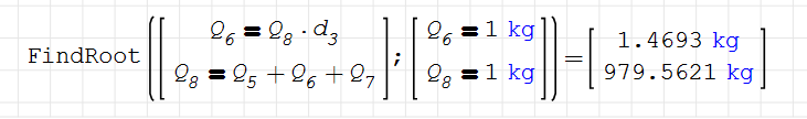

#4 Posted: 1/1/2022 11:22:51 AM
John
John
0 likes in 12 posts.
Excellent reply!
FindRoot is better for my condition, I need units.
Thanks Overlord!
#5 Posted: 1/1/2022 11:25:11 AM
John
John
Thank you, Jean, you're right, I need more practice.

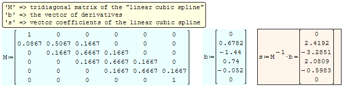

#6 Posted: 1/1/2022 3:38:12 PM
That example has only one CAS route ... naturally 15 D.
