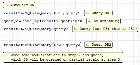

  1. Could you consider using a identifier (number or string) as a "handle" to open connection? For example,
    SQLiteOpen("connection1","path1"="open"
    SQLiteOpen("connection2","path2"="open"
    m:=SQLiteQuery("connection1","query"
    query2:=<some processing involving m>
    SQLiteQuery("connection2",query2)
    <some other processing with both connections 1 and 2>
    Or the SQLiteOpen could return the numeric handle on succcess, or an error with a description on failure.

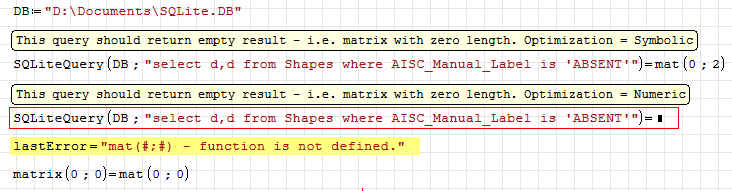

  2. Quote
    If no fields are returned by the database engine, the function will return the string "No Results"
    Imo, it would be better to return matrix(0,0) in this case. And please return a matrix in all cases, even on single return, thus eliminating the need for conditionals in the calculations. If one knows that only single return will come, this may be handled by simply using el(result,1).
Yes, thank you. This is exactly what I have done, SQLiteOpen will now return the index of the database connection that has just been opened, starting with 0. To prevent memory leaks associated with undesired reopening of database files and to speed up sheet recalculation the SQLite plugin will not reopen the same file again and instead return the handle that has been generated when the file was opened the first time. If the file has since been closed it will be reopened but the handle will not change.
A very good suggestion, implemented straight away.

On further consideration, I see the following possible improvements to SQLite plugin interface:
1. SQLiteOpen() is unnecessary.
Rationale: currently, you maintain internally a structure that maps a DB path, "handle" that is returned by SQLiteOpen() and (presumably) an internal session handle. Each SQLiteOpen() invocation checks if the DB denoted by path is already open, and if so, it returns already assigned "handle", otherwise it creates a new session.
This may be implemented instead in any functional SQLite function (like SQLiteQuery()), so that the only SMath database "handle" would be the DB path itself.
The proposal is the following: drop SQLiteOpen(); in all other SQLite functions, make a mandatory first argument "path". At each point in the code where SQLite DB is accessed, use the map lookup to find out if the DB is already open, and open it if necessary.
I believe that the overhead of string comparison is negligible compared to SQL parsing etc., and this would simplify the interface and make it more functional (avoid purely auxiliary function that doesn't return result that is directly useful for user).
2. SQLiteClose is unnecessary.
Rationale: the function's intention is apparently to (1) flush the possible changes made by modifying SQL, and (2) to release the DB file (e.g., to allow its renaming/removing/other file management). But the function isn't guaranteed to be executed. E.g.: if the DB is open (and possibly modified), then goes a lengthy block of calculations, and after that, the SQLiteClose is invoked. A user can interrupt the calculations, thus disrupting the intended resource flush/cleanup. Also, see no.4 below for a concurrent access discussion.
So, to have a robust DB handling, the following is proposed: drop SQLiteClose() entirely as purely auxiliary; instead, on plugin cleanup*, close all open DB connections properly**.
* The cleanup is either at plugin unload (at SMath unload), or at sheet close - see no.4 below.
** The proposed method of closing properly is Commit - see no.3 below.
3. Two new functions are needed: SQLiteCommit(path) and SQLiteRoolback(path).
Rationale: these are functions that allow user to control if and when the data is actually committed to DB. It mat be used if necessary; and may be omitted, thus defaulting to commit at DB closing (see no.2 above).

Next question/feature request: a UI for creating DB and tables. That would be wonderful, esp. for those who don't have other utilities for that. I don't think it's best done with custom functions, rather some dialog UI would be perfect... or a menu item that starts a free external utility for that, that is distributed in the directory with the plugin. Well, I propose dialog UI just because I don't see a good way to do it via functions - but I may well be wrong...
Also:
SQLiteQuery(0,"select * from Shapes"
gives me an error "The cast is illegal" (translated from Russian - specific wording may differ).
SQLiteQuery(0,"select * from Units"
works OK
I suppose it may have something to do with decimal separator? Or a problem when returning an empty value?

But I see a problem with returning empty result sets:
Something's wrong with the approach I suggested (using matrix(0,n)). Maybe Andrey could suggest something here?
I think the approach "matrix as result" is good, maybe there is something to improve in the SS logic. If you try to assign matrix(0,n) to a variable, you can show mat(0,n) in a standalone display of the result with numeric evaluation if at definition is stored symbolically, but not if it is stored numerically (that is the same error while you are trying to display the inline result); this affects also rows()/cols()/length() (unable to process the variable when it is stored numerically). I'll talk with Andrey about this.

WRT empty matrices. There used to be yet another application for them: using as initializers for loops, to assign an empty n-col 0-row matrix to a variable, and then use stack() uniformly in a loop to fill it (of course, if the number of rows is known in advance, that may be done differeently and more efficient). This functionality was definitely available at some point (unfortunately, I cannot find a link to it atm, because I explained this technique in Russian forum, that is unavailable now).

I know about this useful feature, that's why I think this particular form should be enforced

  • Removed single argument SQLiteQuery due to inconsistencies with partial recalculation.

I completely oversaw this issue, to preserve consistency and repeatability even with partial recalculation I have removed the single argument version of SQLiteQuery
