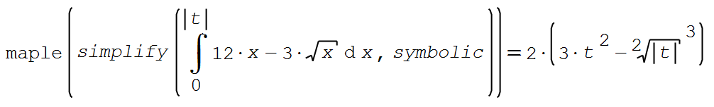

#2 Posted: 10/18/2025 3:12:20 PM
Hi. The default variable in Maple is complex, hence the difficulties when requesting simplifications. However, this syntax makes it somewhat lacking in rigor, which can lead to incorrect results. Therefore, it should be used with caution.
Another way is to use assume in maple, but I don't know how to do it from SMath.

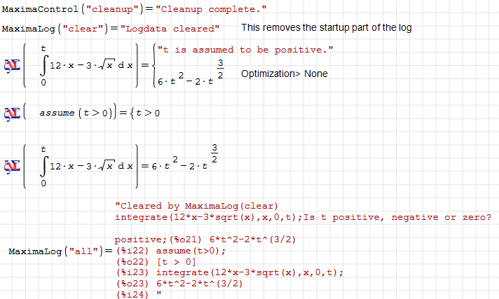

#3 Posted: 10/18/2025 7:12:46 PM
The Maxima kernel asks in such cases for the sign of the limit, the interface catches the question and responds with "yes". In the result, a corresponding message is included.
You can avoid the message using assume().
In the maple plugin this would require to inject assume and the integration in a single maple call, as the maple session does not persist between the calls, while the Maxima session is persistent in the background. There are pros and cons with that approach.
indefinite integral.sm (7.02 KiB) downloaded 1039 time(s).

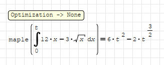

#5 Posted: 10/19/2025 10:57:13 AM
Hello
It really was enough to change Optimization > None for the result to appear correctly.
Thank you very much, everyone!
