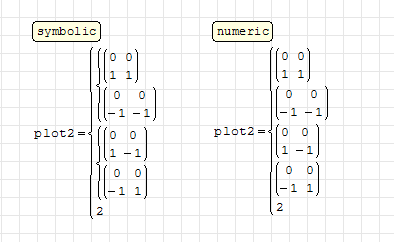

Hello anothersmathuser,
You have to change the optimization of the plot2 definition to numeric, because the special features of SMath systems. You can see what happens by holding your mouse over the plot1 and plot2 definitions.

It works, thanks for your help!
