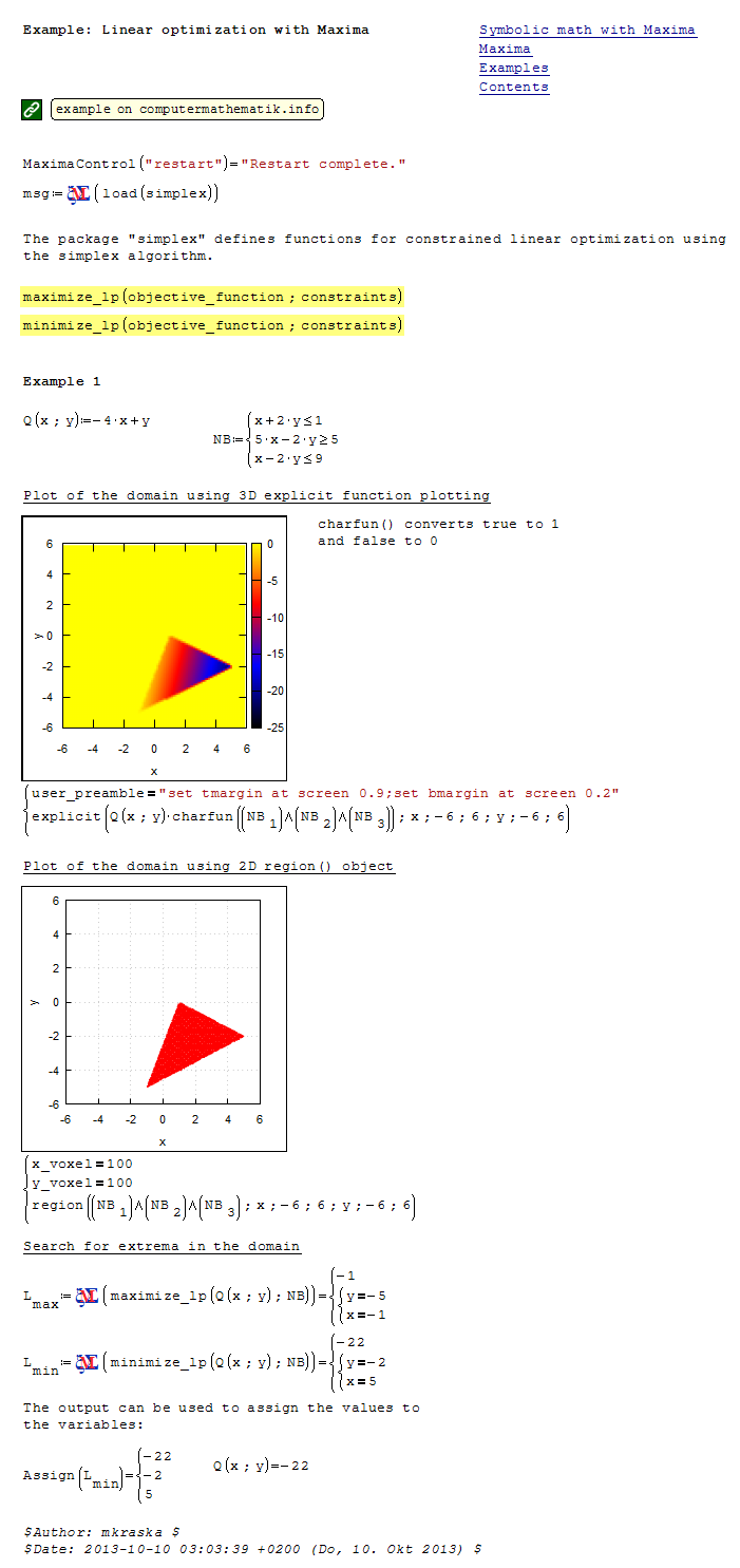

You can use the "simplex" package in Maxima (linear optimization)
See page Examples> Maxima usage> Linear optimization in the interactive handbook.
Example maxima linear optimization.sm (41.89 KiB) downloaded 1203 time(s).

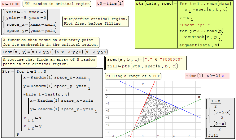

How will you go about solving following problem in Smath
Maybe plot the problem 1rst ?
Next solve solely with Smath, whereas Maxima is not component of stable 6179.

#5 Posted: 12/20/2017 11:59:15 AM
Thanks for the answers Jean would you be kind enough to attach the .sm file too.
Here is + some extra stuff. Maybe there is way to draw an inscribed 3D ?
Solve GivenFind Critical Region Copy.sm (39.35 KiB) downloaded 1234 time(s).

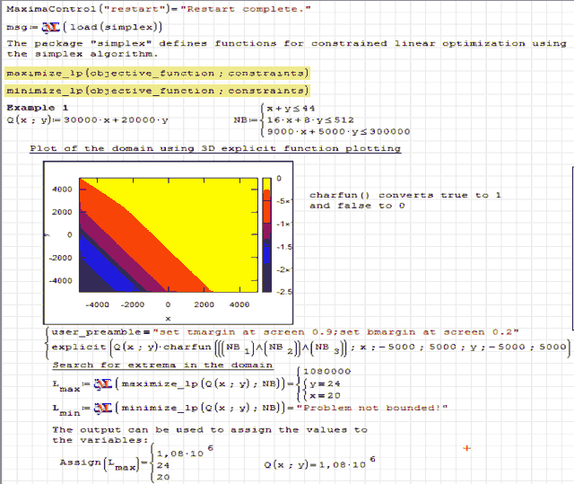

Using Smath Studio with Maxima and the example of Martin Kraska.
Metodo_Simplex.sm (52.26 KiB) downloaded 1237 time(s).
Carlos

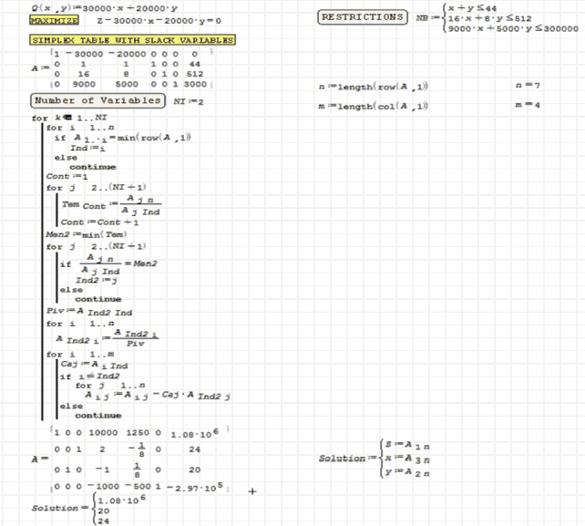

Here is a small and simple Simplex algorithm without the use of the Maxima function.
Small_Simplex_Algorithm.sm (16.35 KiB) downloaded 1257 time(s).
Carlos
CAUTION: The algorithm is NOT TESTED, but it works well for this example.
It is necessary to refine it so that it work in all cases.

A little Simplex algorithm improved
Small_Simplex_Algorithm_Improved.sm (88.5 KiB) downloaded 1210 time(s).
Carlos

I'm sorry, I found a bug in the Simplex algorithm.
Now it's fixed.
Small_Simplex_Algorithm_Improved_2.sm (135.66 KiB) downloaded 1237 time(s).
Carlos
#11 Posted: 12/22/2017 10:12:27 AM
That huge number in the program, can be replaced by ∞ [Smath machine number]
RemToDo => check vs Mathcad
First A[i ... badly indexed.
Small_Simplex_Algorithm_Improved_2.sm (140.42 KiB) downloaded 1242 time(s).
