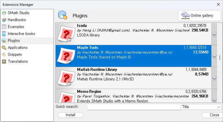

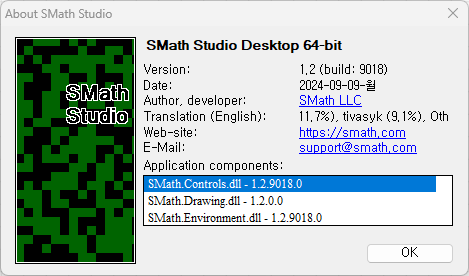

Hello everyone.
i heard that Maple Tools plugin is updated.
I uninstalled the old version before installing the new one.
I'm trying to install the new version, but I keep getting an error.
Below is a video recording of the issue.
https://youtu.be/mwPSEaekRKc?si=5_cvkdZ4CiSZO12D
what is the problem?
Matlab Runtime Library plugin also can not install.
