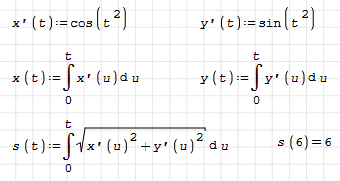

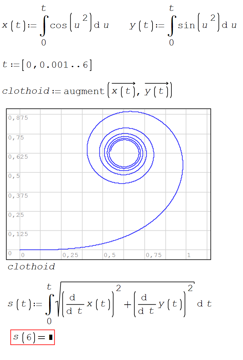

This is a clothoid or Euler spiral (https://en.wikipedia.org/wiki/Euler_spiral). It is said about it that its curvature depends linearly on its length. How to show it in SMath?
Spiral-Euler.sm (5.75 KiB) downloaded 1476 time(s).
#2 Posted: 9/26/2023 8:41:22 AM
1,139 likes in 1,805 posts.
Hi Valery. SMath doesn't know how to handle the derivative of an integral, neither numerically nor symbolically. As workaround, you can try this approach:

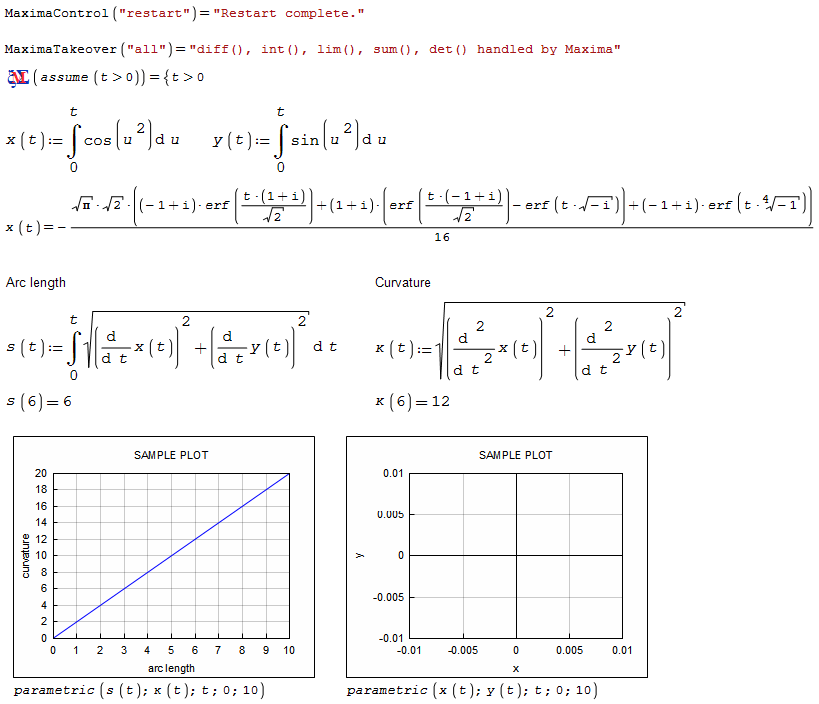

For the attached sheet to work, the Statistical Tools plugin must be deactivated, because it's erf() shadows the Maxima function erf().
The curvature-arclength plot is easily done, yet the xy plot of the curve itself fails because Maxima isn't able to evaluate the functions x(t) and y(t).
Yet, it is not proof of linearity, just an illustration.
Spiral-Euler_Kr.sm (34.32 KiB) downloaded 1466 time(s).
