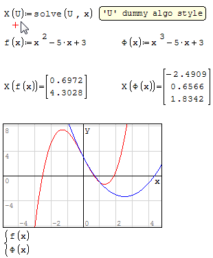

Useful for collecting multiple sets of solutions.
Solve Algo Style.sm (4.97 KiB) downloaded 1290 time(s).

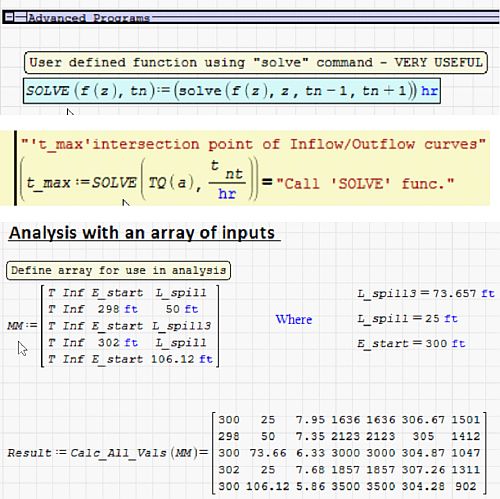

A similar approach used in the attached example.
Small Dams Flood Routing Ex-Program Method-Original-Simple3-R4.sm (1.3 MiB) downloaded 1424 time(s).
#3 Posted: 7/10/2018 10:35:34 AM
Thanks Collab, great project
Page2 NDTMA.sm (88.72 KiB) downloaded 1592 time(s).
