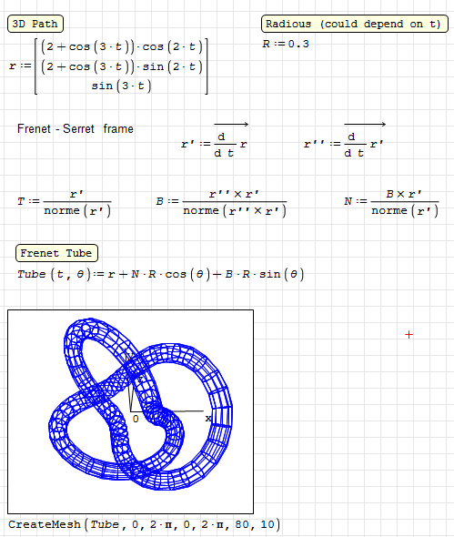

Parametric plot of curve and (2-3) trefoil knots.
What would be really cool would be a meshed torus.
However, I don't know any idea how to do that.

Trefoil torus, not ordinary torus.

Hi Overlord. You can try starting with something this:
Frenet Tube.sm (9.22 KiB) downloaded 1550 time(s).
