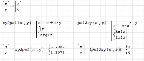

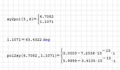

Can I gave the angle of the polar form displayed directly in degrees?
Is there a solution to reporting the rectangular form with real and imaginary parts?
Thank you,

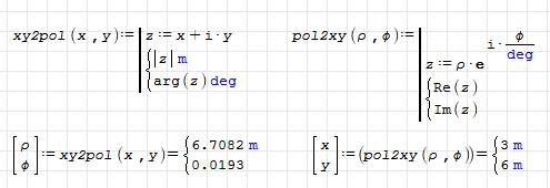

I guess that you can't.
Even you can redefine those functions
degrees are dimensionless, and disappear as unit when you use them
So, you can introduce them into the definition, but don't appear in the answer, like meters, so, guess that it could be a bad idea introducing because you don't see them in the answer.

Not sure what you are after ?
[x:=3,y:=6] => arg(x+y*i) ...
Cartesian2Complex [x:=3,y:=6] => (x+y*i)
Maths xy2pol.sm (89.66 KiB) downloaded 1208 time(s).

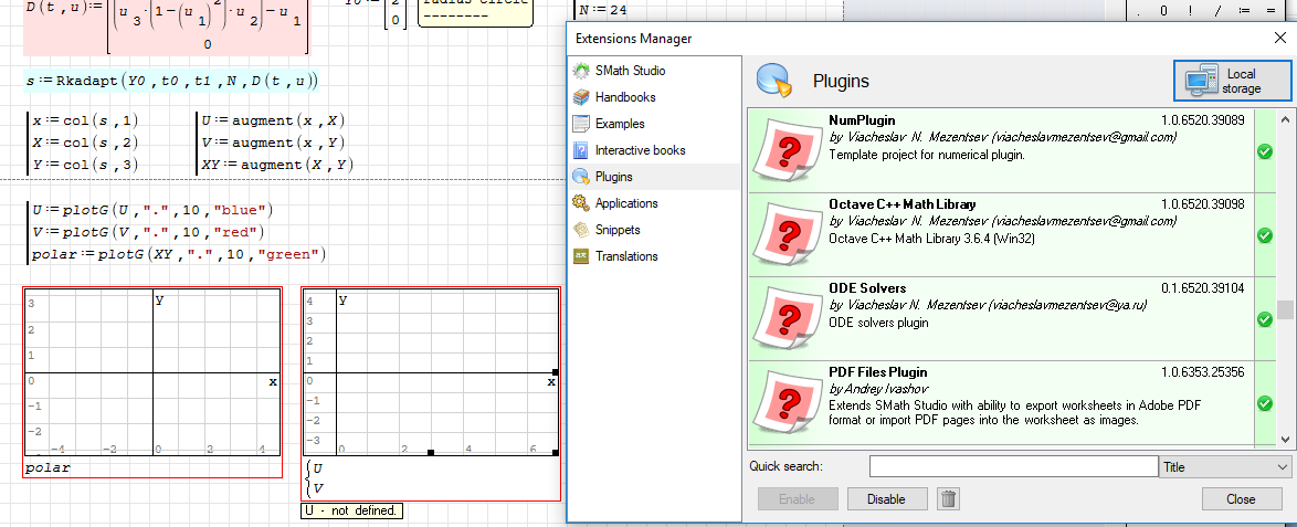

I do not get the graphs!
Basile

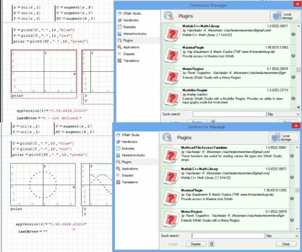

#5 Posted: 2/23/2018 5:41:14 PM
Jean,
Basile
Simple: if "U_ not defined" ... because [x,X] not defined
conclusion: your ODESOLVER plugin NOT installed.

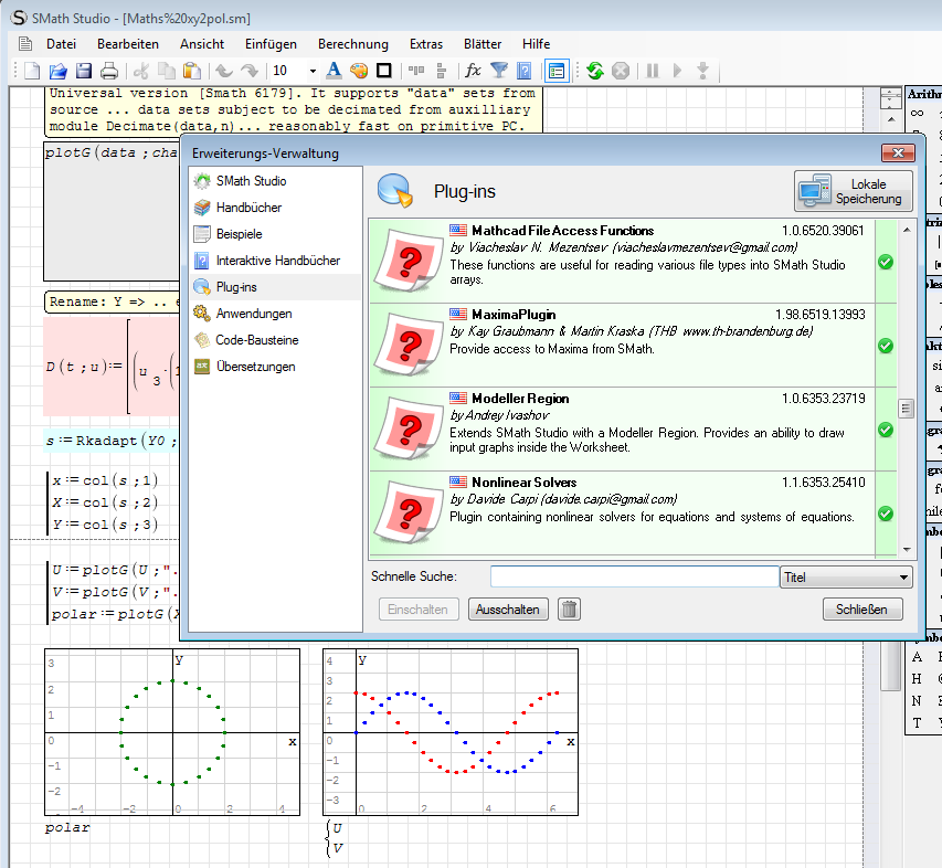

#6 Posted: 2/23/2018 5:46:54 PM
CBG
CBG
78 likes in 312 posts.
Hello Basile:
It seems that Smath Studio current version is working very erratically.
I also had the same problem with graphics, and sometimes they appear and sometimes they do not.
I did the following: I opened the file of Jean, and the graphs appear without graphing anything
and box in red, deactivate the Maxima plugin, and I recalculated the file, and then the graphics appeared.
I close the file and the program.
Again I open the program and the file, the graphics can appear or not, if they do not appear,
then I enable the Maxima plugin and then the graphics appear again.
It seems that the Maxima plugin is causing the problem.
What's going on?
Carlos

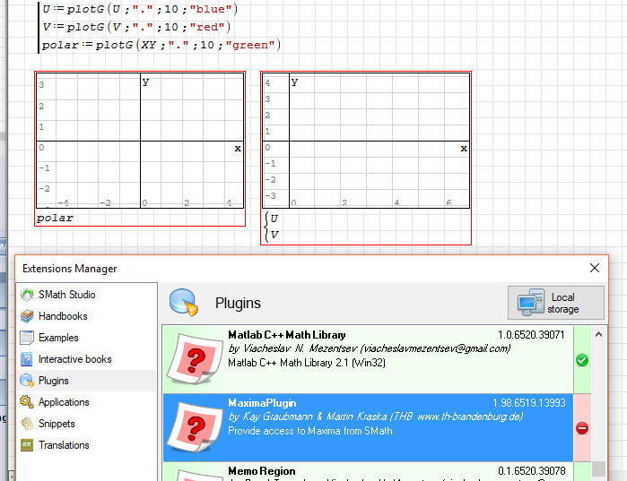

#7 Posted: 2/23/2018 6:53:43 PM
1,361 likes in 2,275 posts.
Can't reproduce the problem

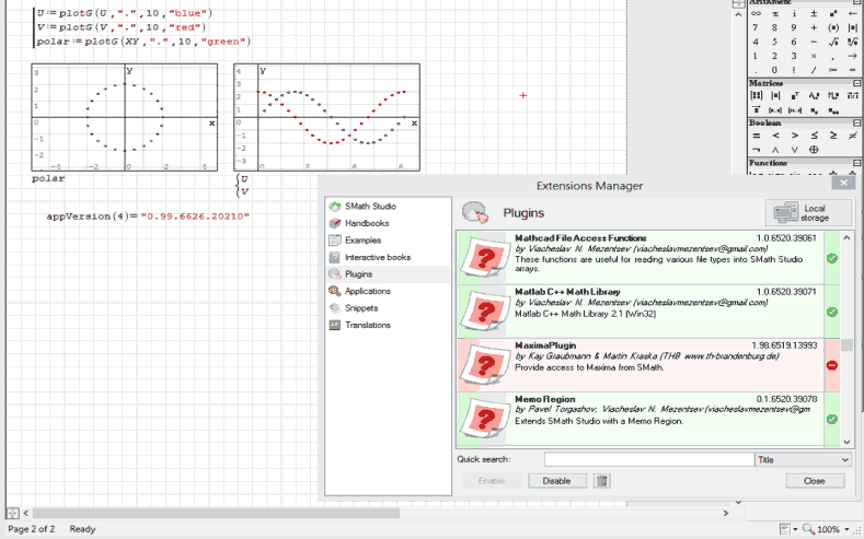

#8 Posted: 2/23/2018 7:44:41 PM
CBG
CBG

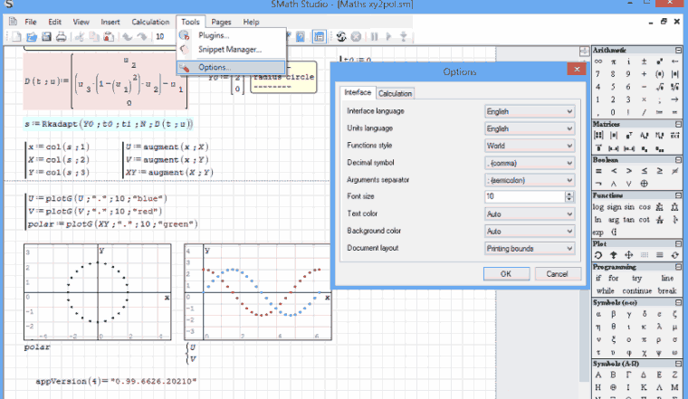

That's why I say that Smath Studio is running very erratically, in the drawing
I show 2 different runs of the same file on the same computer with the same
version but with different results.
How have I arrived at these results?
In the first case, I open Smath Studio in a normal way with all the plugins activated,
I open the file, and the result is that it does not graph.
For the second case, I open Smath Studio, I disable the Maxima Plugin, I open the file,
and then the program correctly graphs, I close the file and the program. I open the program
again and activate the Maxima Plugin, now I open the file, and then it graphs correctly again.
I do not know what may be causing this erratic behavior.
Best regardas
Carlos

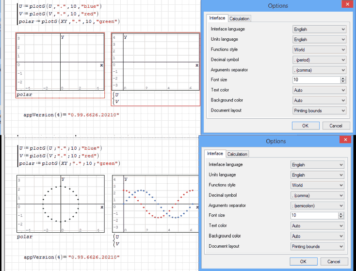

#9 Posted: 2/23/2018 8:15:27 PM
CBG
CBG

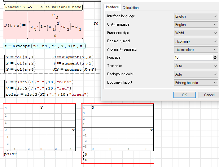

I found the real cause of the problem, and it is the decimal separator,
If you use the period as a decimal separator, then the program causes error and not graphics.
If you use the comma as a decimal separator, then there is no problem
Carlos

Jean,
It is installed.
Basile
#11 Posted: 2/23/2018 11:23:29 PM
CBG
CBG
Basile,
In options, change the decimal separator from "Point" to "Comma", (from "." To ",")
With that change, the file works correctly.
Carlos

Carlos,
It did not work for me.
Basile

#14 Posted: 2/24/2018 11:52:04 PM
Basile
Basile
8 likes in 172 posts.
SMath-08.PNGCarlos,
It does not work for me.
Basile
#15 Posted: 2/25/2018 12:56:21 AM
Jean,
It is installed.
Basile
Your box [PC] may be freaked...
Not from clean purchase, games ...
At this point of all tests, there is no other explanation.
