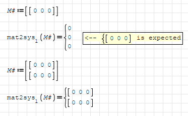

#1 Posted: 12/19/2021 7:02:12 PM
598 likes in 1,380 posts.
When parent matrix has one matrix element, conversion is wrong.
More than one child matrices, no problem.
Matrix converts to sys() correctly.

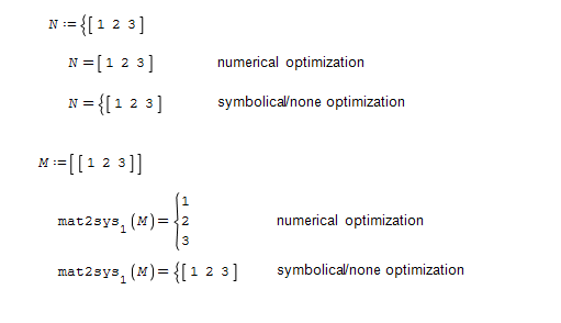

#2 Posted: 12/20/2021 8:02:47 AM
1,443 likes in 2,935 posts.
this is related on how SMath manage the systems. To avoid it, mat2sys must be evaluated with symbolical/none optimization.
