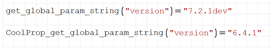

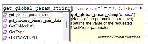

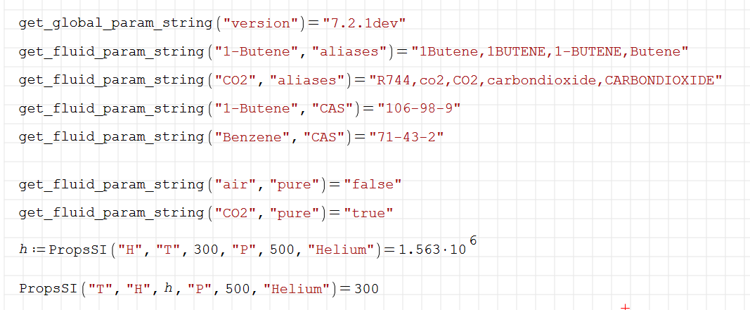

Final follow-up: I had some problems with my PC, which necessitated uninstalling and reinstalling and upgrading a lot of software. In reinstalling SMath and CoolProp, I followed Uni's instructions above and... it all worked!
If I use the Mathcad Custom functions format ("get_global_param_string("version")), I see the installed version of CoolProp;
if I use the CoolProp wrapper format ("CoolProp_get_global_param_string("version")), I see the older version of CoolProp.
