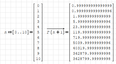

#1 Posted: 9/19/2024 9:06:29 PM
Valery Ochkov
Valery Ochkov
67 likes in 716 posts.
8-5.sm (6.49 KiB) downloaded 1741 time(s).

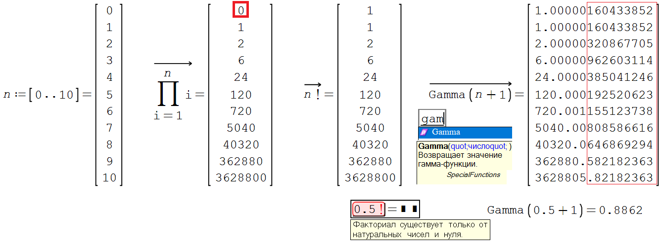

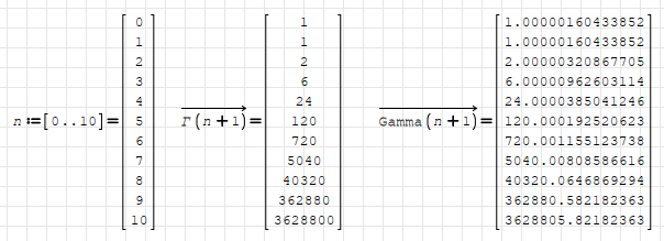

Gamma functions are broken. Not very accurate to be fair.
Use sample functions either from myself or from Razonar's.
https://en.smath.com/forum/yaf_postst20338p2_Gamma-Functions.aspx
gamma_r9.sm (36.93 KiB) downloaded 1940 time(s). <- My sample
gamma.sm (27.93 KiB) downloaded 1985 time(s). <- Razonar's sample
