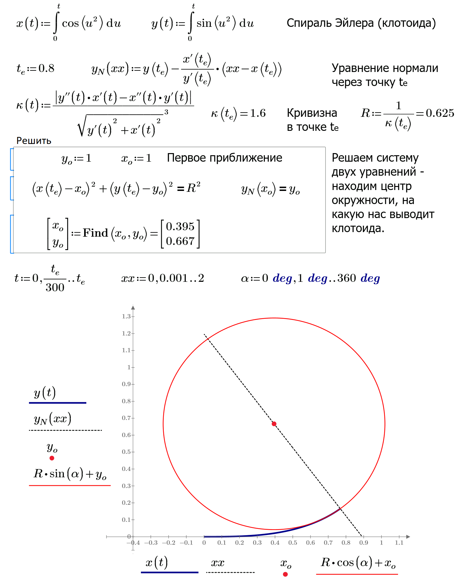

How can I do it in SMath
Edited 5/17/2025 7:14:32 PM

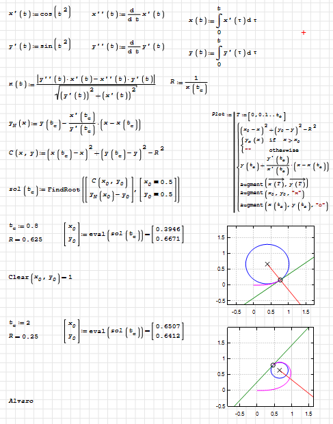

Hi Valery. This could be a way.
Euler-Spiral.sm (23.92 KiB) downloaded 1673 time(s).
Edited 5/19/2025 6:48:22 AM
7 users liked this post
NDTM Amarasekera 5/19/2025 2:25:12 PM, overlord 5/22/2025 1:37:39 PM, Andrey Ivashov 5/19/2025 9:18:07 PM, sergio 5/19/2025 8:17:44 AM, ioan92 5/20/2025 7:37:23 AM, francesco rapuano 5/19/2025 10:31:40 AM, Davide Carpi 5/22/2025 6:34:13 AM

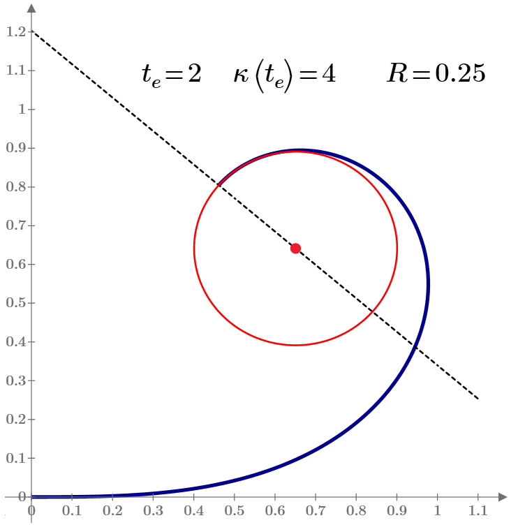

#3 Posted: 5/22/2025 3:48:34 AM
1,139 likes in 1,805 posts.
Animating.
Euler-Spiral Forum.sm (33.9 KiB) downloaded 1659 time(s).
6 users liked this post
