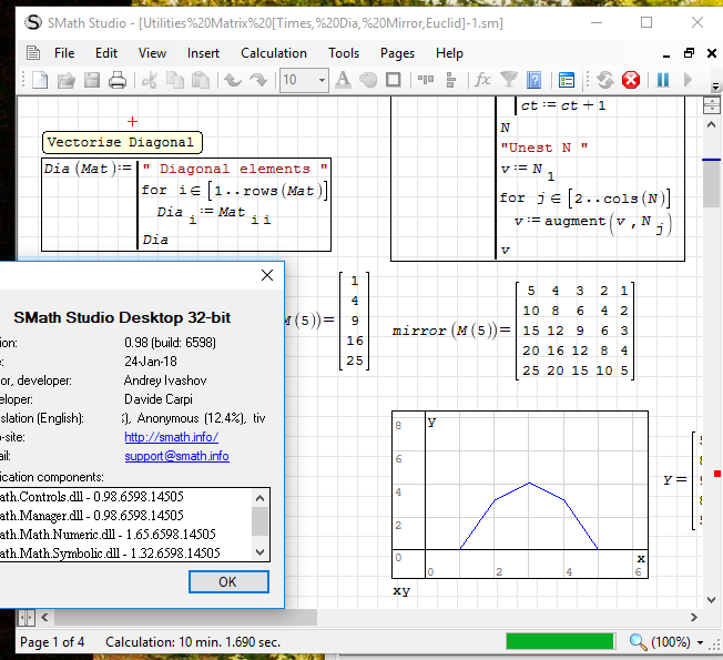

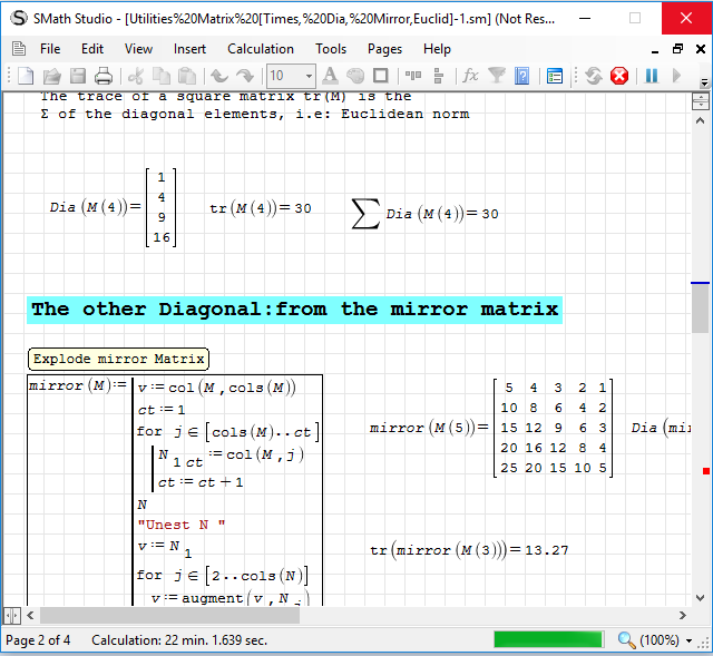

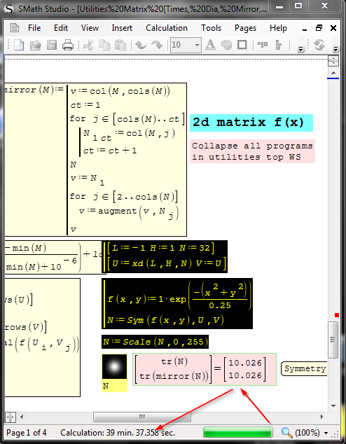

#5 Posted: 1/27/2018 4:38:04 AM
Hello Jean,
A peculiar thing happened to me with your second file and the recent SMath (Win 10 32bit). It just do not stops calculating and I do not have a clue what is going on. Here is the screenshot:
I Do not know where did it stop (see the blue line at the slider, the red square is wrt diagonal of nonsquare matrix error diag2vec() function). There is no green border around any region as well.
Blue slider stopped there and and after about 40 min SMath crashed.
Does anyone can reproduce this? If so, there must be a recently introduced bug then (with for loops maybe).
EDIT: Actually, it did well when I put the Optimization Numeric to all regions, except to the diag2vec() function

My objection was about lenghtly calculation in SMath. The point was, what to do in this situation like on the picture
Waiting such a long time is pointless (it did not stop, as one can see). What to do in the case when you are quite sure that the calculation should not take such a long time? My only answer would be to turn optimization numeric (or use eval()) and see what happened. If this helped, that's OK. If not, try to change something or give it up.

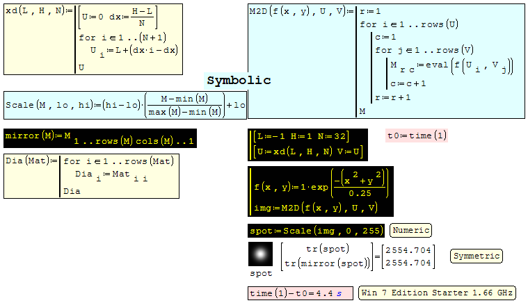

#12 Posted: 1/29/2018 1:14:35 PM
Radovan, try this one ... works fine.
Utilities Most used [2D f(x,y)].sm (48.04 KiB) downloaded 938 time(s).
