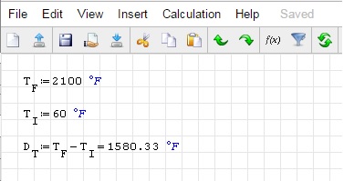

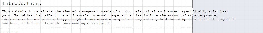

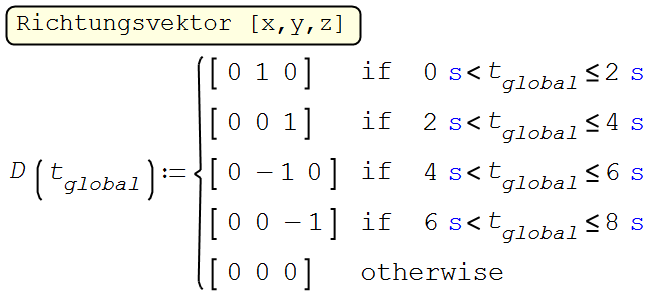

  1. Does anyone know how to mitigate or eliminate the printed space between words? I know there is no fonts in the current release, but my issue is that the test "looks" correct on the work sheet, but has an extra large gap between words when printed (either printer of PDF). See attached example. Almost like the program went into a "Text Justify" mode.

I think it's a bug. The text overruns on different computers. I formatted text on my laptop, when I opened on my desktop (same print drivers) my text is messed up. See attached.

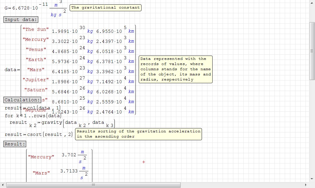

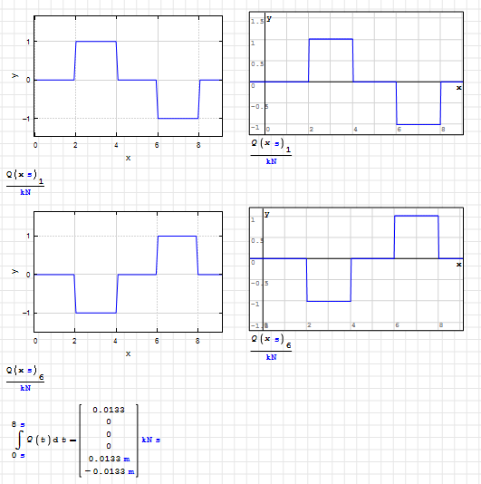

I reported something like that issue when opening one of the built-in samples (menu help->examples)
http://en.smath.info/forum/yaf_postst909_overlapped-regions-when-opening-help-examples.aspx
I can't reproduce it now on xp, i'll try this sample later on my laptop with vista.
You mention that you are working with the portable version, I'll try to confirm this problem with screen resolutions.
#8 Posted: 1/31/2013 4:15:36 PM
kilele
kilele
134 likes in 397 posts.
I thought that the extra space issue was not related to the overlapping regions issue.
I've checked the "computation gravity" sample again on my other computer with different operating system (I have a desktop with xp and a laptop with vista).
I can say it is not related to the portable version and doesn't have to do with changing screen resolutions, I think it might be due to different videocard drivers.
Compare this screenshot with the one I made about a year ago,
there are fewer overlapping regions but the problem is not completely fixed.
