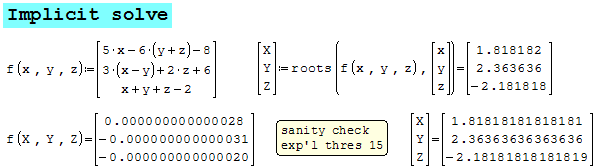

I have to solve a non-linear system of 6 equations and 6 unknowns and wanted to know which function is best suited to solve it.
The right answer is: give the system ... there are many ways.
Solve Algebraic.sm (73 КиБ) скачан 80 раз(а).
Solve Algebraic, NON-Algebraic.sm (176 КиБ) скачан 101 раз(а).
