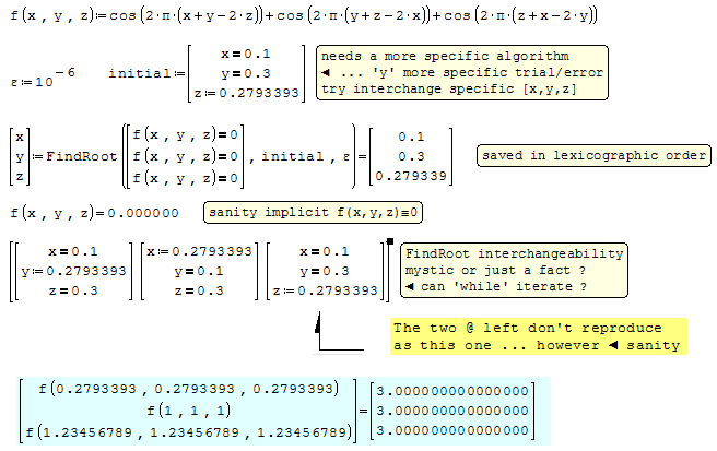

As overlord points, there are infinite solutions. Just like the better visual representation for z = f(x,y) is a surface in the 3D space, w = f(x,y,z) is a hypersurface in the 4D space. But we can't see that plot. So, here a plot of families of that 4D hypersurface, like a contour plot, but with surfaces.
About Dragilev method, I can't find my setup for 3D, and the expert there is Viacheslav (uni).
Plots4D.sm (111 КиБ) скачан 79 раз(а).
Plots4D.pdf (393 КиБ) скачан 95 раз(а).

Well, Fridel it's an expert too, thanks.
Joining above Dragilev and 4D methods.
Plots4D_DM3.sm (111 КиБ) скачан 84 раз(а).
Plots4D_DM3.pdf (182 КиБ) скачан 84 раз(а).
